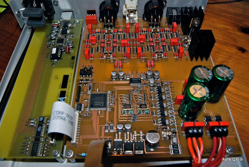

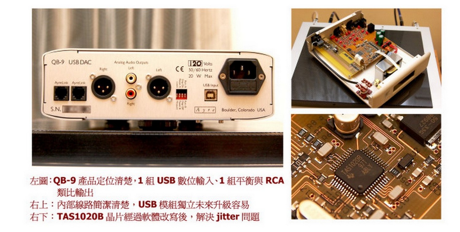

wizard skrev:
Hva gjør TAS1020B chipen?
Det er en usb-reciever ja, det er nettopp denne som er kjernen i den asynkrone overføringen.
Dette er hentet fra Ayre's White Paper om enmet:
What has enabled this proliferation of USB-based D/A converters is a series of parts from Burr-Brown
(Texas Instruments) called the PCM270x series. These parts are inexpensive (only a few dollars), very easy
to use, and require no programming skills. They are similar enough to conventional D/A chips that any digital
audio engineer can easily design a product around them.
The problem with all of the chips in the Burr-Brown PCM270x series is that they have high levels of jitter. A
fixed-frequency master audio clock is not employed. Instead a variable-frequency master audio clock is generated
based on the timing of the incoming audio data. The computer sends packets of audio data at one
millisecond intervals across the USB connection. The Burr-Brown chips have internal circuitry that measures
the interval between the audio packets, and then uses this information to generate a new master audio
clock that matches the rate at which the computer sends packets.
This system, called “adaptive” USB mode, creates several opportunities where jitter will be added to the
D/A converter’s master clock:
1) Any variable frequency clock will intrinsically have more jitter than an equivalent fixed-frequency clock.
In the “adaptive” USB mode, the clock in the D/A converter must “adapt” to match the rate that the
computer sends out audio packets. In the case of the Burr-Brown PCM270x parts, the master audio
clock comes from a VCO and inherently exhibits high levels of jitter.
2) The computer cannot send audio packets at a perfectly fixed rate. Firstly, the computer’s internal clock
is not designed to have low jitter. In a market segment where costs are literally shaved to the fractions
of a cent, it would add too much the cost of a computer to use a high-performance, low-jitter clock.
Secondly, the inside of a computer is filled with RF interference, making it impossible for even the best
of clocks to maintain their spectral purity.
3) The Burr-Brown USB-enabled D/A converter chips update (change) the frequency of the master audio
clock each time a packet of audio data is received. This happens once a millisecond so there will be a
strong jitter component at 1 kHz, right in the middle of the audio band. Typical measurements of the
PCM270x chips exhibit jitter levels in the thousands of picoseconds, orders of magnitude worse than a
well-designed one-box player.
The question remains—is there any practical method of using one’s personal computer to enjoy the
convenience and power of the computer, yet at the same time achieving true audiophile-level performance?
Therein lies a story.
At the same time that Texas Instruments was developing the PCM270x USB-enabled D/A converter chips,
they also developed an obscure part called the TAS1020B Stereo USB Audio Interface chip. This chip
integrates multiple functions into one part—a USB transceiver, a microprocessor, a memory controller with
a FIFO buffer, and an I2S interface to allow easy connection to A/D and D/A converter chips.
Obviously this chip is very powerful and offers great potential to the digital audio designer. The difficulty is
that this chip is a blank slate—completely unusable unless programmed. The TAS1020B offers the potential
for improved performance, but it is no easy task to write the necessary software code for this part. To give
an idea of the complexity of the chip, the datasheet is no less than 110 pages long—and it doesn’t even tell
the full story. Let us just say that tackling a project with the TAS1020B is not for the faint of heart.
A “third-party” company has been certified by Texas Instruments to develop software for the TAS1020B.
This company mainly works with manufacturers in the “pro” audio business, but also supplies their
software solution to several audiophile-oriented companies. Their code allows high-resolution audio data
(up to 96/24) to be transmitted across the USB port. While this approach offers the advantage of allowing
the transfer of high-resolution audio data, it does little to address the jitter problem inherent in the
PCM270x chips.
Their software averages the timing interval of four audio data packets instead of measuring each individual
packet, but the master audio clock still changes frequency 250 times per second. And unlike the analog PLL
used in the PCM270x parts that can continuously change the frequency of the master audio clock, the
TAS1020B has a frequency synthesizer that can only change in discrete steps, exacerbating the jitter
problem. However, as the D/A chip is now separated from the USB receiver, many audio companies use
some sort of jitter reduction circuitry between the two, often in the form of an ASRC chip. But whatever
approach is used, these circuits can only reduce jitter and not eliminate it.

Ayre is proud to be the first licensee of Wavelength Audio’s new “asynchronous” USB technology called
Streamlength software. For the first time ever, Ayre can make an external D/A converter box that has the
critical master audio clock where it belongs—right next to the D/A chip itself, and without resorting to a
non-standard interface.
Her er et annet innsidebilde
