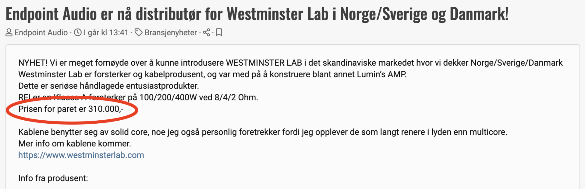

Endpoint Audio er nå distributør for Westminster Lab i Norge/Sverige og Danmark!
NYHET! Vi er meget fornøyde over å kunne introdusere WESTMINSTER LAB i det skandinaviske markedet hvor vi dekker Norge/Sverige/Danmark
Westminster Lab er forsterker og kabelprodusent, og var med på å konstruere blant annet Lumin’s AMP.
Dette er seriøse håndlagede entusiastprodukter.
REI er en Klasse A forsterker på 100/200/400W ved 8/4/2 Ohm.
Prisen for paret er 310.000,-
Kablene benytter seg av solid core, noe jeg også personlig foretrekker fordi jeg opplever de som langt renere i lyden enn multicore.
Mer info om kablene kommer.
https://www.westminsterlab.com

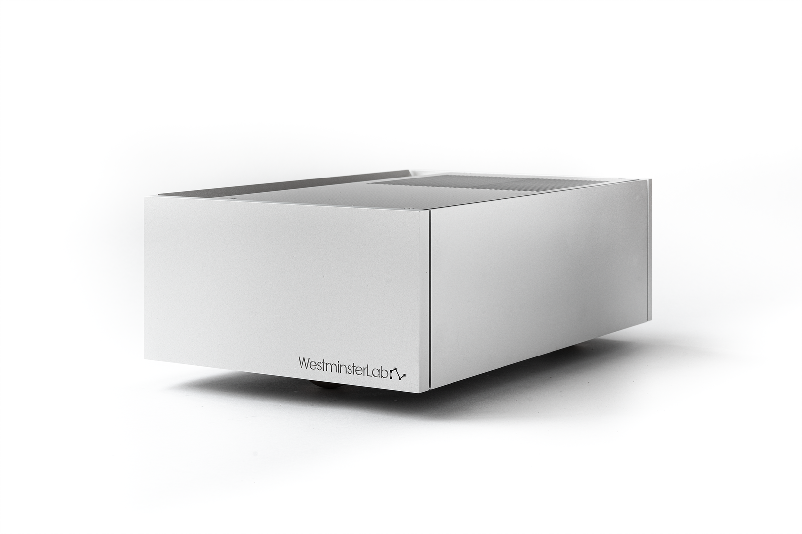

Info fra produsent:
Not The Typical Class A
The Rei employs a WestminsterLab proprietary iBias and CCS systems, what it means in terms of electronically. The Rei will warm up much faster than other typical Class A amplifier, and the iBias technology constantly varies the bias depending on the current and also the loading of the amplifier. And the result sonically, is you get the best of the Class A without the typical draw backs. Is truly unique.
Built Like No Others
Stability and rigidity of the whole amplifier is one of the key criteria to a outstanding amplifier. This is because under a stable environment, signals and power can go through a more stable, undisturbed flow. For that, the chassis must be very stable and rigid with very low resonance and vibration.
Rei’s concept of mechanical structure is completely different from UNUM, instead of just having one unibody like UNUM, the main load bearing chassis of the Rei amplifier is constructed with two very rigid CNC machined aerospace grade 6063 aluminium components.
Why two? Because we can separate the mechanical vibration between power supply components and the “amplifier” electronics. From our test, we realised the power supply has a micro-mechanical vibration at the power supply frequency and its harmonics, which is very different from other electronic components within the amplifier. And this unique construction media this phenomenon to the minimum.
The exposed exterior panels of an amplifiers absorbs a lot of micro-vibration within the audio-band from the speakers. Hence these external panels of Rei are designed to have resonance as furthest away from the audio-band as possible and anchored to the power supply chassis, away from the delicate and sensitive audio electronics.
SPECIFICATION
Rei - Class A Amplifier
Power
100 watts @ 8Ω
200 watts @ 4Ω
400 watts @ 2Ω
Power ( Bridged )
400 watts @ 8Ω
800 watts @ 4Ω
Frequency Response
5 Hz to 40 kHz, ±0.1 dB
2Hz to 52 kHz, -1 dB
Distortion
(100 watts @ 8Ω)
<0.1% @ 1 kHz
Signal-to-Noise Ratio
104 dB, A-weighted
Input
1 balanced XLR input
Output
1 balanced XLR output
Input Impedance
200 kΩ
Output Impedance
0.018Ω
Dimensions
W232 x H112 x D320 mm
Weight
16KG
