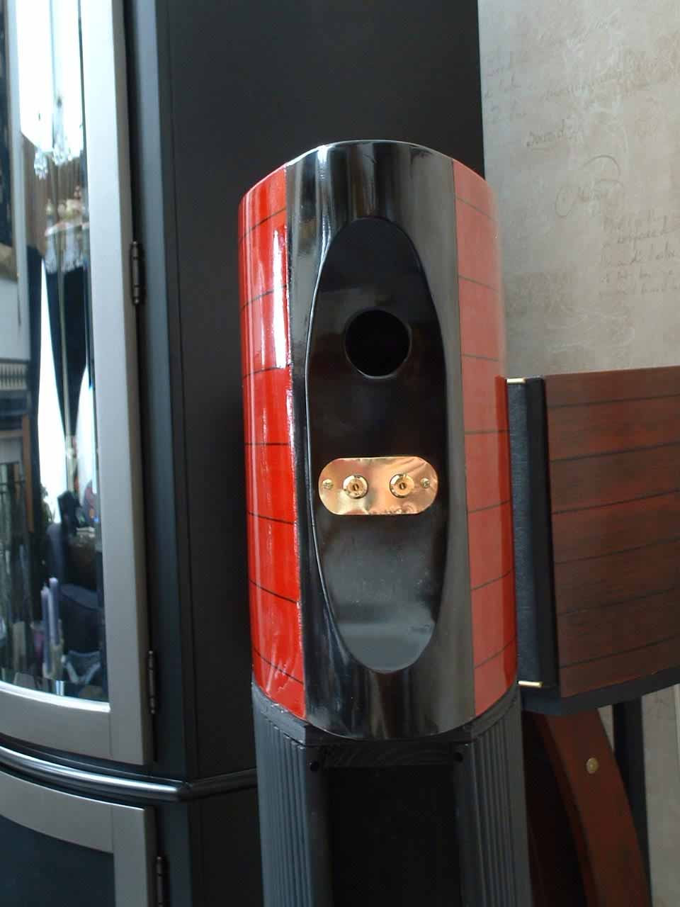

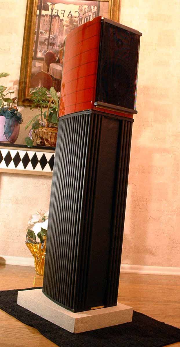

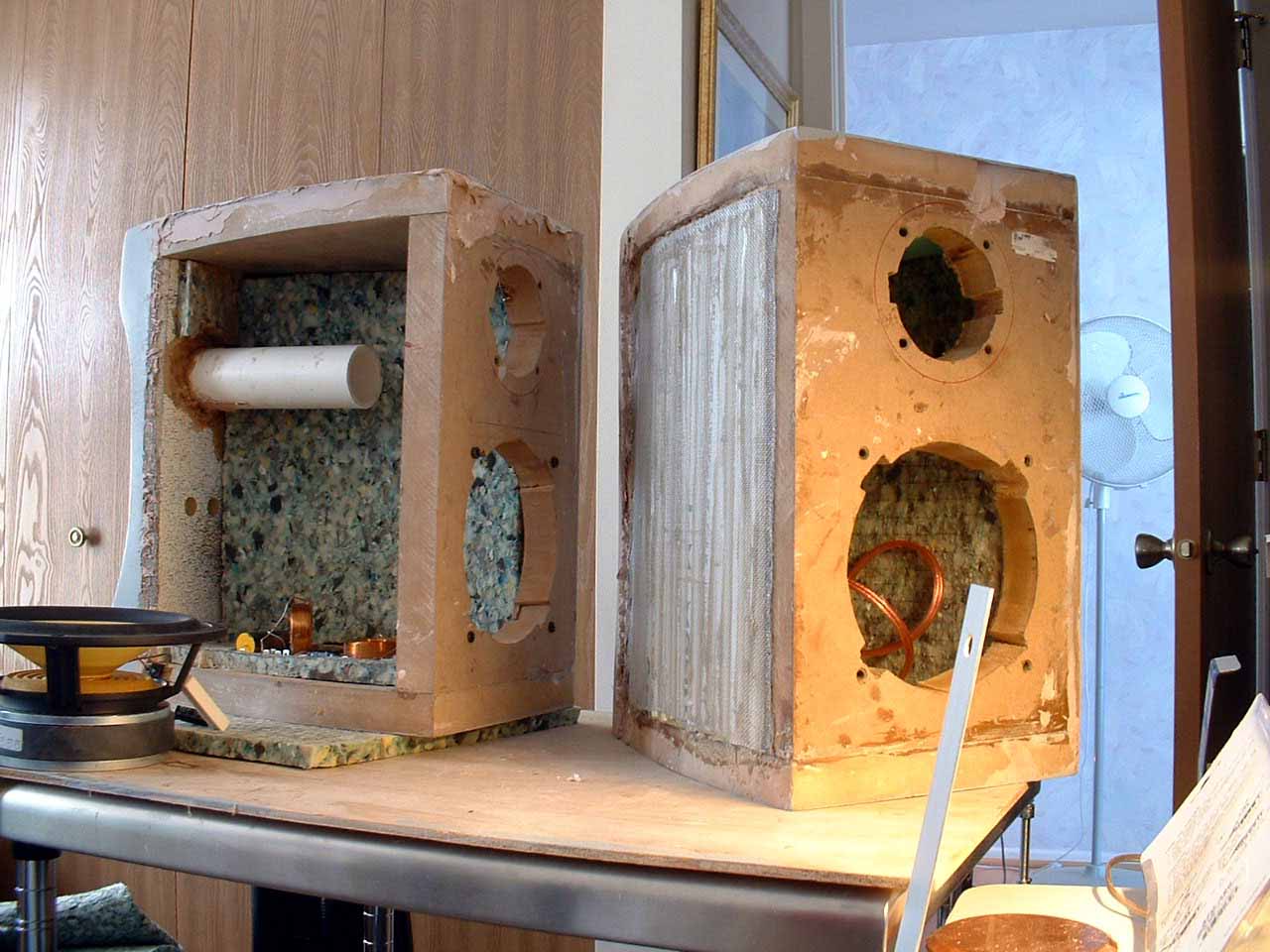

    Fant en til i samme gata, mulig det er samme typen:
    Speakers------
    Made the top, bottom, front and rear baffles out of 1 1/8" mdf.
    Filled 1/2" pvc pipes with sand and plugged them with dowel plugs.
    PVC pipes were then lined up vertically and glued with pvc adhesive around the curved sides.
    Aluminum screen stapled to front baffle and stretched to rear where it is stapled there.
    Bondoed sides and sanded, and bondoed and sanded and sanded and....
    Skim coated top with bondo.
    Rear was made by same technique covering a rudderlike frame. Painted w/Rustoleum Professional Black spray paint.
    Faux finish is with hobby paints with several coats to imitate SF red color. 3 coats of Minwax gloss poly 1/2 diluted with mineral spirits rubbed on and sanded between coats.
    Finished speaker is 15" high and weighs 35 lbs.
    Grill covers------------
    1mm black stretch bracelet cord wound around 3/8" threaded rods to form even spaced design. Pvc adhesive to secure in place.
    Rods then placed in 1/2" aluminum panelling channel. Channel ends folded up and drilled to accept threaded rod ends. More pvc glue. Channels painted black and covered w/black vinyl.
    Stands--------
    1/2" pvc pipes lined vertically for sides.
    Center support is 4" x 4" composite fence post (only front of it showing). 3/8" threaded rod through post and top/bottom.
    Base is 2 1 1/8" mdf panels stacked and painted with Rustoleum Bleached Stone simulated paint.
    That's mostly it. Simple.

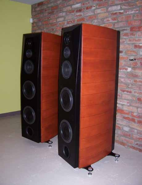

    Er den siste der virkelig ikke en Usher?

    Den visuelt mest vellykkede av disse synes jeg faktisk er den jeg kommenterte.

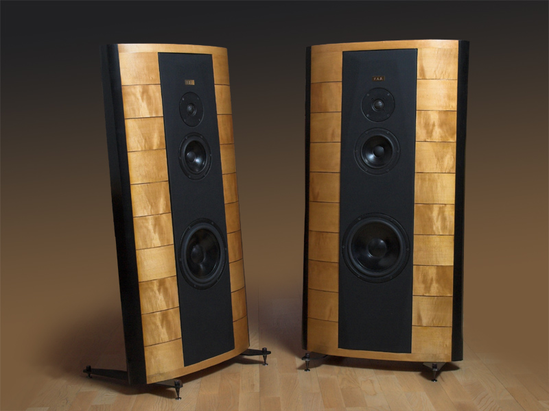

    Gravesen-Straden hadde vært interressant å høre. Den begynte jo nærmest som en "hvorfor gjør Serblin det slik?"-studie.

    Og mine DIY Seas 3-veis begynte som "hvorfor gjør Gravesen det slik", og endte opp med noe som har null og niks med Sonus Faber og gjøre. Annet enn at baffelen er bred som på Stradivari Homage og Elipsa da :)
    Jeg synes "kopiene" på bildene over her er imponerende jeg, selv om de kanskje ikke når helt opp til ultranivå på finish, er det unektelig meget pent utført.
