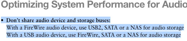

Står i bruksanvisningen til PM:
Mvh.KW

KW skrev:
Men hva da med dette;
Mvh.KW
Da får noen som forstår seg på PM og teknologien der svare. Så vidt jeg kjenner til mener både Weiss og Metric Halo (som jeg har) at dette ikke er en stor sak. Jeg har ingen formening.
Derfor er det greit å kjøre en HD med flere grensesnitt (FW og USB) hvis en mener at lyden blir forskjellig i de to oppkoblingene. Slik sett er det jo et ikke-problem.
Og har du nevroser grunnet problematikken, spør Weiss!
Tillegg:
Dette står å lese i manualen for Metric Halo.
«METRIC HALO SPECIFIC:
• “How many boxes can I use on one FireWire bus?” This depends on the sample rate you’re working in. You can currently use three interfaces on one bus at 44.1-48 kHz, and two at 88.2-192 kHz.
• “Can I attach hard drives or more interfaces to the second FireWire port on my MIO?” Yes, with two things to remember:
1. Remember the rules about connecting FW800 and FW400 devices on the same bus.
2. If you’re recording at high track counts or sample rates, you may need to connect your hard drive to another bus (or another type of bus, like SATA).
• “I can’t expand my Mac, so I can’t add another FW bus or SATA bus. How can I work with high track counts?”
Try using a USB 2 drive. While you want FireWire’s isochronous transfers to get audio into your com- puter, asynchronous transfers to your hard drive are fine. If you are having dropouts, noise or other problems in your audio chain with your interface and drive on the same bus, try connecting the hard drive via USB to lighten the load on your FW bus. Even if you decide not to use the USB drive full time, this is a good troubleshooting tool.»
I det oppsettet vi snakker om her (Mini/HD/[ADC/DAC], så skulle ikke dette by på problemer, etter hva jeg kan se.
