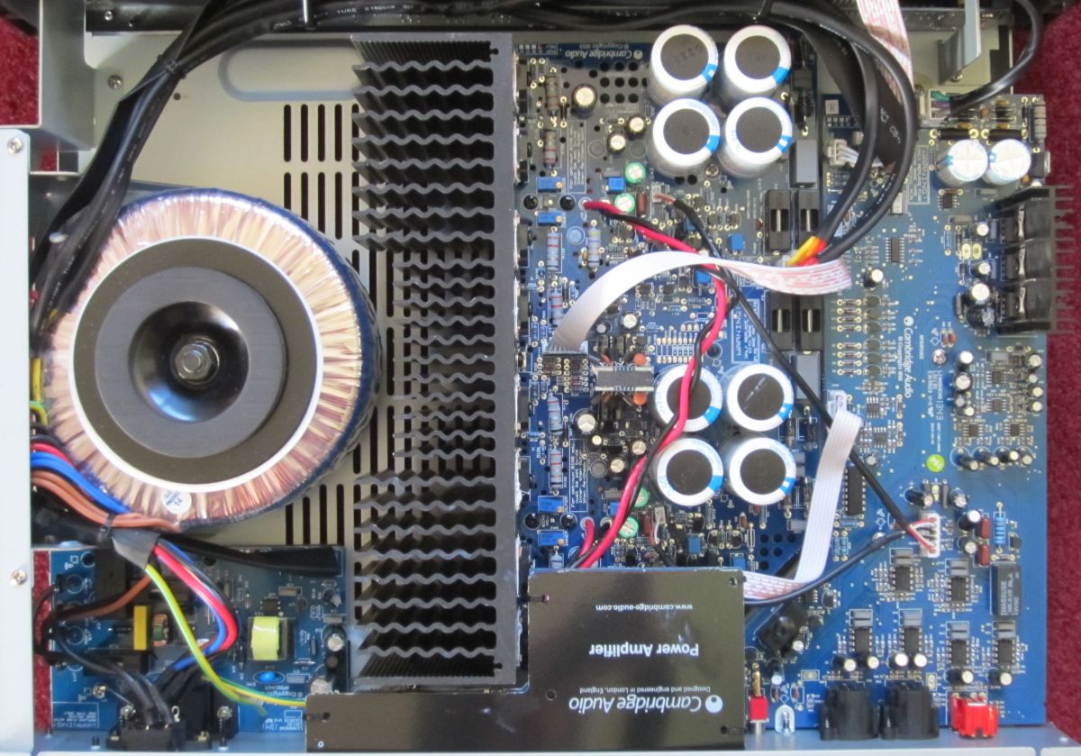

Så vidt jeg vet er dine Cambridge Dual mono
laget med hensikt som å være 2 monoblokker i et kabinett.
Ser ut som at det er en trafo ja, men...
l Dual mono design. The 651W uses a clever dual monoamplifier design – this means that we take separate feedsfrom the large toroidal transformer and process the leftand right channels separately, meaning that the 651W iseffectively two mono block amplifiers put together in onechassis – this gives superior stereo imaging and sound-staging to the competition.
