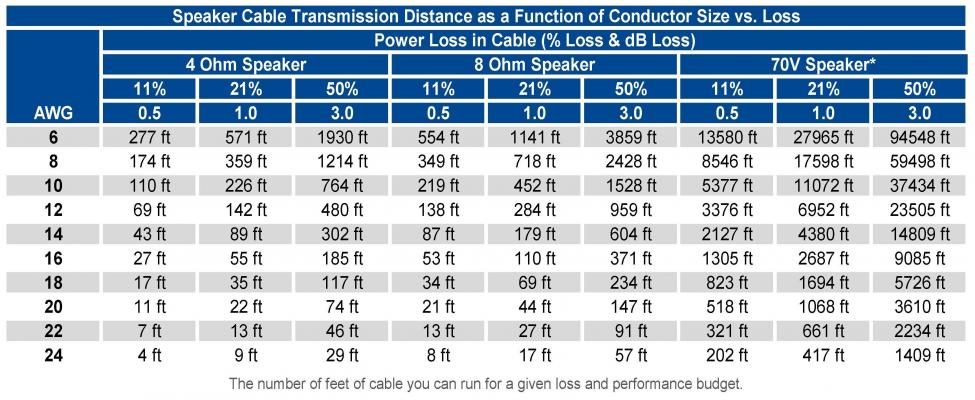

Maximum Wire Lengths For TWO CONDUCTOR Copper Wire
Wire Size2 ohm load4 ohm load6 ohm load8 ohm load
22 AWG3 feet max6 feet max9 feet max12 feet max
20 AWG5 feet max10 feet max15 feet max20 feet max
18 AWG8 feet max16 feet max24 feet max32 feet max
16 AWG12 feet max24 feet max36 feet max48 feet max
14 AWG20 feet max40 feet max60 feet**80 feet**
12 AWG30 feet max60 feet**90 feet**120 feet**
10 AWG50 feet max100 feet**150 feet**200 feet**
For example: you can use#18 wire for a 25 foot run to a nominal 8 ohm speaker, but if the run is increased to 35 feet, #16 wire must be used. (**) 50 feet is the maximum recommended length for normal line cord or Romex solid copper wire. This length is more than adequate for most installations. An explanation is further down on this page titled "What about Wires Longer Than 50 Feet?".

I bruksanvisningen til forsterkeren min (MA7000) står det følgende:
When connecting Loudspeakers to the MA7000 it is very important to use cables of adequate size, so there is little to no power loss in the cables. The size is specified in Gauge Numbers or AWG (American Wire Gauge). The smaller the Gauge number, the larger the wire size:
If your loudspeaker cables are 50 feet (38.1m) or less,use at least 14 Gauge.
If your loudspeaker cables are 100 feet (76.2m) or less,use at least 12 Gauge.
Jeg ble plutselig litt i stuss på hvordan jeg skulle forstå dette. Betyr det at høyttalerkablene mine (ca 2,5 meter hver) bør ha 14 gauge eller mer, altså 15, 16 osv.? Eller betyr det at jeg bør ha gauge under 14? De skriver jo at jo mindre gauge nummer, jo større kabelstørrelse...
Noen som kan oppklare dette?

Som du skriver er lavere gauge tykkere kabel. Selv bruker jeg gauge 10.
De skriver: Viss dine høyttalerkabler er 38.1 m eller mindre, bør du minst ha 14 gauge.
Men du har helt rett, jo kortere strekk - jo tynnere kabel kan en ha, og få like tall for motstand. Med 2.5 m kabel kan du ha mindre enn 14 gauge.
Så da tolker du det som at minst refererer til selve tykkelsen (altså at man anbefales 14 og under) og ikke til selve tallet.

Vel, her beveger vi oss inn på et område jeg ikke skal være bombastisk om.... og der det finnes et utall ulike syn.
Om jeg skjeler til de mer vitenskapelige tilnærmingene til HT kabel og egenskaper, vil en nok si at sålenge en har tilstrekkelig tykk kabel (liten motstand) vil et hakk tykkere kabel ha lite å si.
Det som derimot har mer å si for lyden er kabelens induktans (som bør være så lav som mulig) - og ikke minst kapasitans (som må være passe). Hvordan kabelen er isolert og om lederene er tvinnet vil påvirke.
Når det kommer til kapasitans kan en enkelt si at kapsitans demper refleksjonene i kabelen som oppstår i kabelen mellom ledere/komponenter med ulike egenskaper. Overgangen mellom HT kabel og HT er her den viktigste. For lite kapasitans kan gi for lite dempning av refleksjoner, som igjen kan gi en hørbar endring av lyden.
Skulle jeg tatt den helt ut mtp kabler, hadde jeg studert og målt egenskapene til både HT og forsterker - og på bakgrunn av det funnet en kabel med de egenskapene som jeg tror gir minst refleksjoner og best overføring. Jeg tror det meste skal la seg regne på - men det er fryktelig lenge siden jeg regnet på noe slikt sist.
