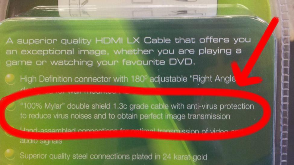

Ser ut om klassisk google translate fra kinesisk :)
Ser sånn ut, for en brøler.
[h=3]uemouth Interactive[/h]Hi Jimmy - we've just heard back from our manufacturer. It seems there was an error in the "to English" language translation. The 'with antivirus protection to reduce virus noises' reference should have read - when translated to English - '100% mylar double-shield cable to reduce interference to obtain perfect image transmission.' We apologise for the oversight. Very seldomly things like this unfortunately do slip through. We'll fix this shortly in any residual marketing communications. In a positive sense, this product has been superseded for some time and this translation does not feature on the successor HDMI cable we now offer to retail. If you have any questions feel free to give us a call on +613 9646 4011 - ask for David Tipton; BM
