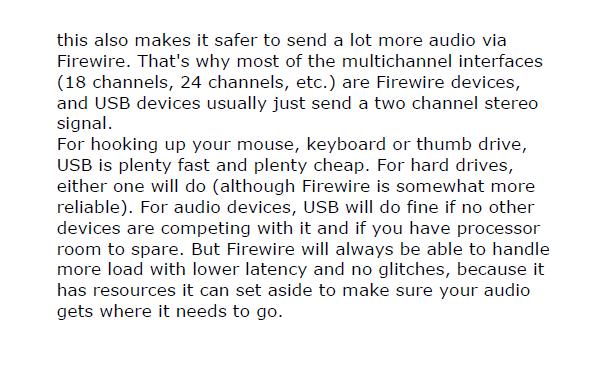

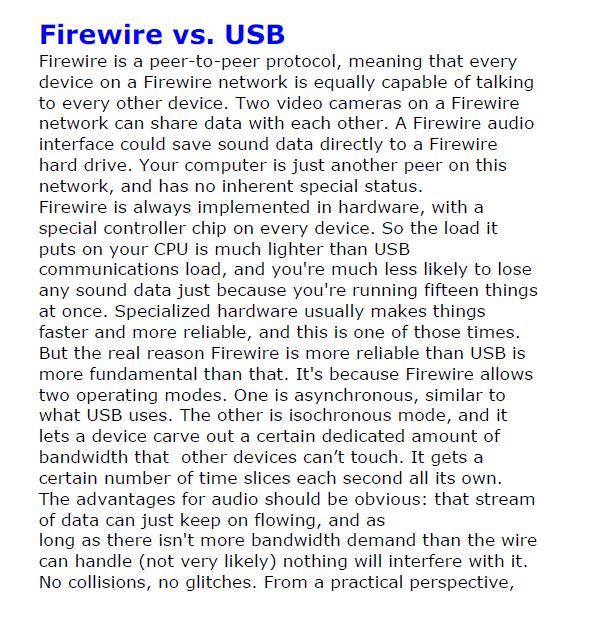

Her er vel den ene produsenten etter den andre ute etter å fremme sin egen fortreffelighet. Det dCS sier står vel litt i kontrast til det Weiss sier (kilde Computeraudiophile):
"Weiss prefers FireWire over USB for several reasons. Similar to USB FireWire offers the asynchronous operating mode. Unlike USB, FireWire also offers isochronous mode that allows devices a dedicated amount of bandwidth. This insures the audio stream will keep flowing without interference from collisions or glitches. As most Computer Audiophile readers knowUSB DACs work great as long as there are no other devices on the USB bus that interfere with the DAC i.e. the keyboard and trackpad on MacBook Pro models. USB also puts more load on the CPU. Fortunately for many computers this load is negligible when audio is streaming to an external DAC. FireWire does seem like the way to guarantee a smooth audio stream to the DAC, but it is not without its detractors. Some in the industry preferUSB 1.1 because it allows a 24/96 audio stream without the need to install additional device drivers. Traditionally FireWire also has more jitter thanUSB interfaces. To handle this Weiss uses the Jitter Elimination Technologies (JET) PLL. This features state of the art jitter rejection and extremely low intrinsic jitter levels."
"Weiss prefers FireWire over USB for several reasons. Similar to USB FireWire offers the asynchronous operating mode. ...."
Helt sikkert, men det som er litt komisk (synes jeg) er Weiss' iver etter å bruke ordet asynkron når hans dacer nettopp ikke er dette.... Det er en ganske artig diskusjon om dette nedenunder testen av DAC202 på Computeraudiophile, her.... ;)

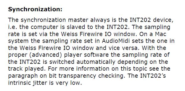

johnnygrandis skrev:
...utrolig hvor mye den klokkestyringen kan ha og si for hvordan bitstreamingen leveres til dac.
Klokkestyring? Koblingen mellom pc/mac og INT202 er adaptiv. :)
Skal ikke se bort fra at jeg missforstår men utifra hva jeg leser trodde jeg det var en (klokke?) styring i Weissen som gjorde at pc`en ble slavet mot denne. (i mitt tilfelle minien)

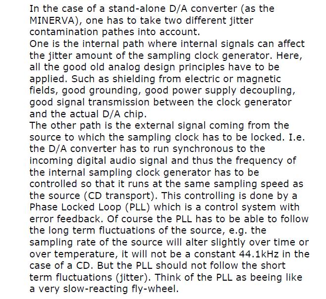

Bruk av PLL og ordet asynk i ett og samme produkt er vel egentlig en selvmotsigelse..? DICE II chipen som sitter i INT202, DAC202 etc. støtter ikke asynk.... Weiss definisjon av asynk er nok derfor litt annerledes enn Wavelenght, dCS, MH etc. - hvilket kommer frem under diskusjonen jeg linket til i #15. Sånn jeg forstår det så bruker Weiss en adaptiv PLL-basert kobling og etterfølgende ASRC (Asynchronous Sampling Rate Converter) = asynk.. :-X
For at et produkt skal være (ekte) asynk så skal en ha to "fixed-frequenzy" klokker (FFCO); en for 44.1-multipler og en for 48-multipler, som flow-kontrollerer pc/mac = slaver. :)
