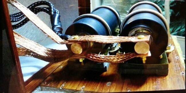

Tripoints variant
Entreq Tellus grounding - Page 172
Det brukes en elektrodemasse også ved smelteverket her.
Mener å huske noe svart granulat.Mulig "Breuer" her på
sentralen vet noe mer om dette :).

Ground Boxes | Entreq
and work like a bit of Mother Earth in concentrated form and offer the simplest and fastest route for this high-frequency noise to reach a earth point. Since such are very high-frequency weak currents, it is not necessary to have a lot of mass; but it is important that the cables are optimized for these high frequency and the groundbox be a purely attractive earth point.The construction and choice of materials in the earth box has a crucial effect on the result. In part, the minerals and metals involved have an effect, but the relationship of proportion and distance between them also affects the result.
