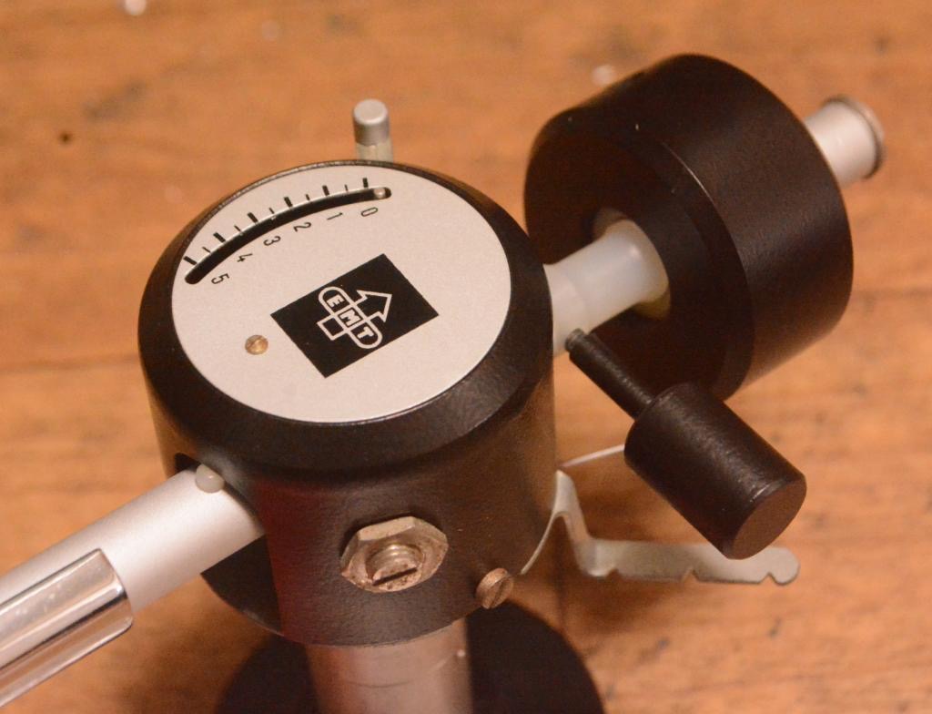

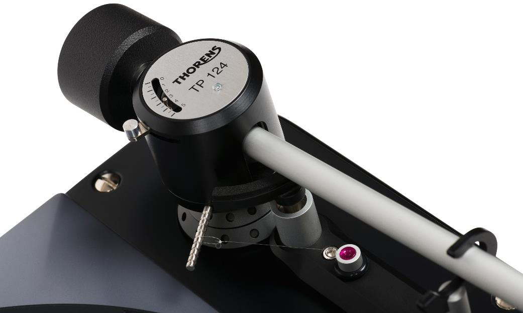

    Pussig, dette med armen:
    «Nyutvecklad tonarm och pickup TP 124 heter den nya tonarmen och aldrig tidigare har man kunnat justera en tonarm från Thorens så här mycket.»
    Det er jo en EMT med Thorenslogo som sitter der ja ?

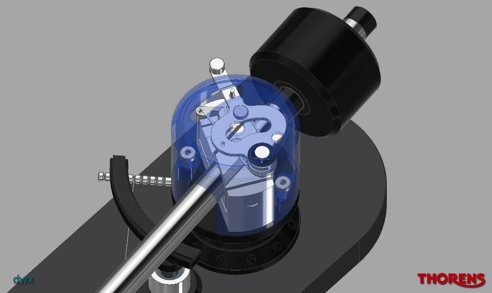

    Er det? jeg vet ikke! har ikke armen/spilleren..selv om jeg synes den ser spennede ut!...selv sier Thorens;
    "Also new is the tonearm TP 124. It can be precisely adjusted in all parameters to the cartridge of choice and features an innovative anti-skating solution with a ruby bearing and a patented electric tonearm lift to facilitate gentle placement and removal of the stylus. The completely newly developed TP 124 is a cardanic suspended tonearm with Löfgren geometry. A high-precision Japanese ball bearing with special oil is used as the horizontal bearing".
    page5image1234381600
    In addition to the extensive adjustment options, the enclosed head shell with SME connector provides a great deal of flexibility when it comes to selecting a cartridge. The TD 124 DD also comes with an additional, slightly heavier counterweight that matches the Thorens SPU TD 124 pickup, which is available separately.
    page6image1147395568
    Thorens TP 124
    Ikke meningen spamme tråden Fozzy, sorry om du synes det blir for OT, si ifra så tar jeg det bort.

    Det er bare jeg som ikke kan min Thorens, de har visst lignet på EMT lenge.
