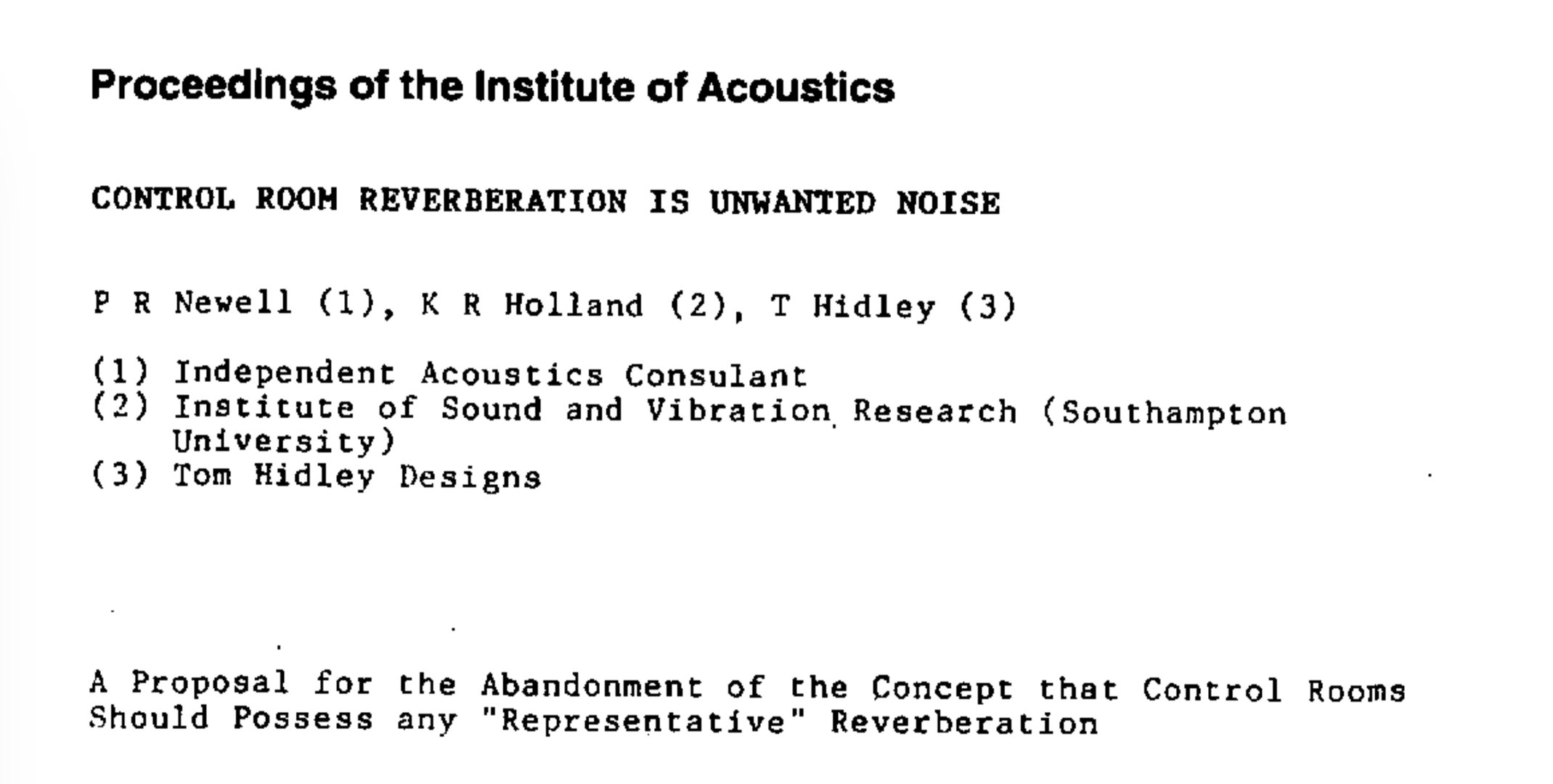

    Det meste av bra lyd kan jo sjekkes ut her.
    Det slår skjeldent feil.
    Mye fra Fleetwood Mac er av elendig kvalitet.
    Men hører sikkert ikke hjemme her.
    Her har diskusjon gått over i kontrollrom for det meste. Sov godt til alle oss som er opptatt av god lyd og setter det øverst.
    Fikk ikke lagt ved. Min feil og trøtt.

    ER ROMKLANG UØNSKET STØY?
    Newell, Holland og Hidley reiste i 1994 spørsmålet om profesjonelle lydfolk burde forlate bransjenormen for lydrom. Her er innledningen i artikkelen CONTROL ROOM REVERBERATION IS UNWANTED NOISE, publisert av Institute of Acoustics i 1994:
    «It has been customary practice in most situations to produce control rooms with reverberation times approximating to, or slightly less than some statistical "average" domestic listening room. Numerous methods have been used in attempts to remove peaks and dips in the reverberation times of the rooms, which create idiosyncratic colouration of the monitoring conditions. This has led to musical balances which may not "travel well" when reproduced in other rooms. Despite fifty years of efforts to produce rooms which subjectively sound both consistent between themselves and "typical" of the outside world, the general state of inter-room compatibility is still not good. This paper argues that only by minimising control room monitoring RT can greater commonality be achieved; but this requires the abandonment of any adherence to the old policy of mimicking any perceived domestic "norm"».
    De fremmer det de kaller en «praktisk løsning» på den uønskede støyen som rommet bidrar med:
    «It has been becoming apparent to a growing number of people that the optimum monitoring conditions for current recording requirements would be an anechoic room in which human beings would feel comfortable. The achievement of this requires a room with a dual acoustic, one for the monitoring and one for the people working within it. If the front wall is made to be both massive and reflective, and the main monitor system is flush mounted in this wall, then the wall itself provides an excellent baffle extension for the radiation of low frequencies, but cannot be "seen" in ray-diagram terms by the monitor loudspeakers themselves. By making the wall suitably irregular on its surface, very pleasant specular reflexions can be returned to the persons within the room in response to their speech and actions, but nothing of the musical signal from the loudspeakers can be returned to the front wall, and hence back to the listener, as all other wall and ceiling surfaces are made as highly non-reflective as possible over as wide a frequency range as possible».
    De mener løsningen med non-environment room fungerer:
    «In the "Non-Environment", "Monitor-Dead" rooms, one very strongly noticeable trend is towards recording and mixing on the large, in-built monitor systems, with the small close-field systems returning to their original position in the hierarchy as secondary references to a domestic world. Users report few surprises when taking the mixes away to play at home, in the car, or on headphones, which is hardly unexpected as the rooms remove one of the very large variables from the mixing environment, and by also removing the bias towards one form of reproduction (the domestic reverberation time) other listening environments are more fairly considered at the mixing stage».
    Avslutningsvis redegjør de for bruken av ordet «støy»:
    «Noise
    What is becoming more and more apparent as the use of these rooms spreads, is that control room reverberation should be considered to be nothing other than unwanted noise. Like tape noise or non-linear distortions, it masks detail by introducing a noise floor below which it becomes very difficult to hear other noises, distortions, or low level signals. Many important aspects of a sound may exist at times in a region of say 65dB below peak. A tape noise floor of -60dB will make perception of these sounds very difficult, and may even mask distortions. The reverberant hang over of a sound can in a similar way easily mask the low level detail of a sound existing two or three hundred milliseconds later, and it is many of these low level signals which provide clues to the spaces in which the instruments were recorded. What makes control room reverberation even more of a potential problem to monitoring than is tape noise, is that the tape noise is part of the finished item. Undesirable though it may be, the same tape noise which masks the problem in the control room, will still be present to mask the self same problems in the homes of the purchasers of the recordings. The same cannot be said however for any masking due to control room reverberation. Although it may cover problems at the recording and mixing stages, the unheard problems can become only too apparent to critical listeners in the outside world, and as I stated previously, quality control is not their job, it is ours! They have paid for a finished product and they are justified in expecting the best value for their money».
    Spørsmål som kan reises:
    • Er du enig i at rommet bidrar med støy, eller er rombidraget noe positivt?
    • Hvis rombidraget er positivt, hvorfor ikke maksimere rombidraget?
    • Hvis rombidraget er positivt, men bare til en viss grad, hvilken metode skal man følge for å balansere miksen mellom rombidrag og høyttalerens direktelyd?
    • Hva tror du er best for de profesjonelle lydfolkene; å produsere i et rom som er som en gjennomsnittlig stue, et rom som følger normen i lydbransjen eller følger anbefalingene fra Newell, Holland og Hidley om å fjerne alle refleksjoner unntatt de fra frontveggen og gulv?

    Før du får svar av oss andre. Hva er dine egne tanker rundt disse spørsmålene?
    Du poster mye linker og stiller mye spørsmål, men det er ikke så lett å få tak i hva du tenker og mener om ting selv. Så når du stiller disse spørsmålene, så kunne det være en idé at du lufter dine egne tanker og refleksjoner rundt spørsmålene du stiller. Blir mulig enklere med en med fornuftig dialog om man vet hva du tenker også, så man ikke bare ender opp med å diskutere rundt endeløse sitater.
