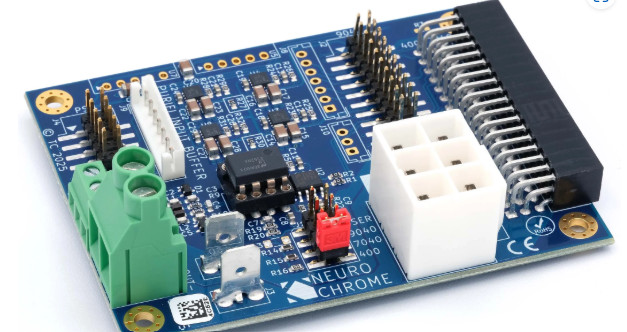

    Neurochrome (Canada) er ute med en ny versjon buffer for hele Purififamilen av forsterkermoduler. Samt Hypex NC500. Sistnevnte er vel ikke så aktuell da den er forbeholdt OEM.
    Ser ut som Tom Christensen ikke har gjort seg bort denne gangen heller. Spesifikasjoner i spitzenklasse ! Forøvrig så er denne ferdigbygd. Så det er bare plugg og spill. Usikker på om den er form and fit ift f.eks EVAL 1 bufferen til Purifi (Skruehull etc).
    Kremt hrrmff 1: Den har forøvrig 8 pins sokkel på Op-ampen slik at Hiendismens menighet kan bedrive sine ritualer og sådan oppnå en høyere tilstand "der oppe" . Vel beskrevet tidligere i tråden.
    Kremt hrmmff 2: Armand har vel noe å strekke seg etter her, hvis han ikke har "dunket inn ballen" allerede ? Gung ho !
    This input buffer is designed for the following Purifi and Hypex Class D amplifier modules: 1ET400A, 1ET6525SA, 1ET7040SA, 1ET9040BA, and NC500.
    Key advantages:
    • Fully differential output for full power, even with a single-ended source.
    • Controlled common-mode voltage to prevent power supply bus pumping.
    • Four independent ultra low-noise voltage regulators for analog and digital power.
    The buffer is a single-channel (mono) buffer, with the following features:
    • Differential (balanced, XLR) input, which can easily be configured for single-ended (unbalanced, RCA) operation.
    • Fully differential output even when used with a single-ended source.
    • Common-mode feedback ensures zero common-mode output voltage to avoid power supply bus pumping.
    • Jumper-selectable gain: 11.6 dB, 13.0 dB, and 13.2 dB for a total amplifier gain of 26.0 dB when used with the Purifi Class D modules.
    • Gain can be further customized by adding a resistor (1206 size SMD and leaded/PTH supported) or set to unity gain (0 dB).
    • Plug-and-play connection with Hypex SMPS1200 power supply.
    • Four ultra low-noise voltage regulators power the analog and digital circuits of the Buffer and the amplifier module. Optionally, you can add the Hypex HPR/HNR regulators.
    • Speaker output is provided on 6.3 × 0.81 mm quick-connect spades and a terminal block accepting up to AWG 10 (5.2 mm2) in size.
    In addition, the following options are provided for advanced users:
    • By adding a resistor and a 7-pin connector, the amplifier module can be operated in software mode. See the relevant amplifier module data sheet for details.
    • The buffer can be disabled by removing two resistors. A 3-pin connector footprint provides direct access to the input of the amplifier module.
    The Universal Purifi Input Buffer circuit board is fully assembled, RoHS compliant, and is designed and manufactured in Canada.

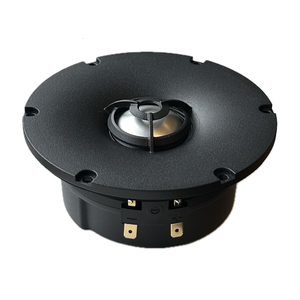

    Noen med tanker om at Purifi PTT6.5X08-NAA-08 er bedre enn PTT6.5X08-NFA-01? Mitt hode spinner rundt ift mellomtoner i aluminium, tror elementene er "forholdsvis like", men fortsatt ikke. :unsure:
    En del forskjell på følsomhet og xmax, men xmax har lite å si for min del da de skal deles av over bass-område uansett. Lavere følsomhet på NAA som gjør den mindre egnet som en mellomtone i mine øyne. Får gruble litt til. :)
    Ift Purifi-diskanten, den ser jo spennende ut, men det gjør mye annet også.
    NFA er 4 Ohm, NAA-08 er 8 Ohm.
    NAA strekker seg litt høyere i frekvens om man skal gå 2-veis.
    Key advantages:

    Det virker som om det er litt annerledes løst enn Armand sin buffer. Den op-ampen som sitter i sokkel er muligens satt opp som et differensialtrinn eller noe. Men det sitter ytterligere 4 stk der som muligens er i signalveien. Siden gainjumper sitter på andre siden kan det være at den i sokkel sitter sist i signalveien. Siden den er dobbel er det uklart om det i det heletatt sitter et differensialtrinn på kortet. Faktisk kan det hele mine om en liknende krets der man bare trekker ut CM uten å gjøre signalet ubalansert. Beskrivelsen av input minner om en Whitlock-løsning også. Det han kaller "common mode feedback" kan iofs være en sånn ground bootstrap sak som følger CM. I såfall har kretsene mye til felles. Blir spennende å se når det kommer skjema.
    Det de derimot ikke har til felles er at denne mangler "kelvin probe" sensing på regulatorer. Det kan vi si fordi den er kompatibel med Hypex sine.

    Tom Christiansen (Neurochrome) vet hva han driver med og bufferne hans er gjennomtenkte og gode. Men når det gjelder CMRR er ikke dette noe mer enn "vanlig" (som for såvidt også er godt nok i de fleste tilfeller).
    Han bruker også separate regulatorer til de forskjellige spenningene som trenges for Purifi 1ET9040 modulen. Den trenger faktisk 7 forskjellige spenninger:
    * +/- 50V (Main power)
    * +/- 12V til opamper
    * +5V til mikrokontroller
    * +5V til analog low voltage circuits
    * +15V til MOSFET drivers
    Jeg koblet opp en slik en i kveld.
    Alle de nødvendige spenningene lages "på gamlemåten" med egen sekundærvikling og regulator per spenning. Hovedtrafoen på 1.5kW er utenfor bildet
    1ET9040 har en hel haug med data man kan hente ut fra modulen med en mikrokontroller. Jeg har skrevet en kode som henter ut det viktigste nå i testfasen.
    A vektet støy ligger på 4.9uV. Og det er på utgangen av en forsterker som kan levere over 1000W effekt! Denne kan kobles rett på et horn uten at det er et snev av støy.

    Det lå et fantastisk dokument ute på International Rectifier sin side en gang i tiden. Det var et slags kompendium for å lære å konstruere klasse D, men selvsagt med bakteppe som application note for deres gate drivere. Husker ikke hvem som kjøpte dem opp, men lurer på om det var NXP.
    Uansett, her trakk de frem hvordan klasse D har naturlig dårlig PSRR på grunn av at avvik i driftspenning på gate driver og trinnet foran forplanter seg. Jeg er usikker på om det betyr at 9040 trenger like stabil spenning til op-ampene, men det kan være at dette skillet også gjør at FET-driverne også blir mindre sensitive. Op-amper av god kvalitet har gjerne rimelig god PSRR.
    Men hva i all verden er denne 5V analoge greia? Har den ikke for høyt signalnivå til å kunne bruke 5V som psu i signalveien? Kan det ha noe med logiske gater ifm dødtidjusteringen å gjøre?
