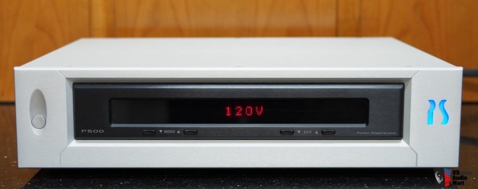

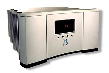

    Kanskje noen av sannheten ligger i det som nevnes under? Blant annet at slike strømrensere tilfører egenlyd og er derfor det låter annerledes. Ble nevnt et sted at det var målt at en PS audio regenerator økte tredje harmonisk forvrengning opp til 6%.
    Jeg sitter ikke med svaret, men liker å forstå ting og tar ikke alt for god fisk. Spørsmålet er hva eventuelt skaper forandringer. Er det rensing av strøm, placebo eller kan det faktisk være tilført forvrengning? Eller en kombinasjon.
    If you change from the standard sinewave, you change the peak value. A square wave for example is 170v, no longer 120v. I won't get into the calculus here but a square is 100% energy, the sinewave has "areas" where there is less than 100% power being generated. The net result is you are overpowering your gear. Now if it has a switch mode power supply, it doesn't matter. But a 60hz power transformer won't like the extra voltage. Not to mention the magnetic theory problems these "distorted waveforms" cause. Yes, "multiwave" is adding distortion to an otherwise near perfect sinewave.
    I find it comical that PS preaches the horrors of distorted AC sinewaves and to some extent they are quite correct. It's not as bad as they claim but nevertheless it's not good either and can cause interference in AV gear. But then they they turn around and add their own blend of distortion back in and call it "multiwave".
    Why can't they just produce a clean AC sine wave and be done with it? I'll tell you why, because then they have nothing more than an on-line true sinewave UPS unit I can buy in the computer market for half the cost!
    But they aren't telling you about the internal regulation found in almost any audio source gear and all video gear these days. A linear series pass regulator will remove any ripple down to the white noise of the pass transistor as long as it's higher then the regulator dropout voltage which is most certianly is. So the net effect of reducing input ripple is nil.
    Are they lying? No, the multiwave will lower input ripple on a simple capacitor input power supply. But power supplies today are much more sophisicted than that and the ripple is taken care of in the regulation stage. In a switch mode power supply, the ripple you get is a combination of 120hz and harmonics of the switching frequency which is at least tens of kilohertz. In this case the swithing noise amplitude far exceeds the 120hz AC ripple so reducing that is of no little to no benefit. Also a lot of the switch noise harmonics get into low level analog circuits via RFI, that is through the air as radio signals. You can clean up the incomming AC until the cows come home and you still won;t get rid of the RFI from a poorly shielded switch mode power supply.
