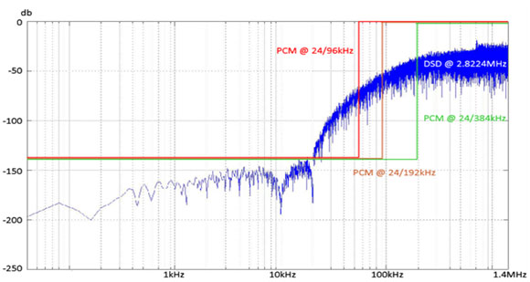

    Utdyper mer om hva som menes med : mer plass til det som ikke er musikksignal.
    Som nevnt ligger hovedtyngden av forskjellene mellom CD og SACD i mastering, men DSD har bedre arbeidsbetingelser i utgangspunktet og det vil høres på de beste oppsett på gode innspillinger.
    "DSD 64fs (the format used for SACD) is a 1 bit format with a sample rate of 2.8224 MHz (64 x 44.1 kHz). The main advantage of this DSD format is the as close to perfect as we have ever seen impulse response, which is just a little more than 100% measured with a 3us pulse, plus the very wide frequency band. The disadvantage of DSD compared to digital PCM is the noise performance and the fact that DSD can not be edited since it is only 1 bit.
    In our AX24/Sphynx 2 we have been able to keep the noise down until 23 kHz (<-120 dBfs measured 20-20 kHz), however the energy from the noise is still part of the signal, so after 23 kHz the noise becomes increasingly significant.
    Since DSD can not be edited as a one bit signal, it is necessary to convert to some kind of multi bit for editing. When converting back to DSD the modulator noise will be added again, and after just a few editing back and forth the audio will no longer comply with the noise performance specification stated in the Scarlet Book (specifications for SACD’s). DSD 64fs is used as recording format in Sonoma, Sadie and Pyramix DSD systems. (Pyramix can also record in DXD).
    There is also DSD 128fs, also 1 bit, but with a sample frequency of 5.6448 MHz (128 x 44.1 KHz). Since it is a 1 bit signal, quantization noise is equal to DSD64, but since the frequency band is twice as wide, the noise is only half that of DSD 64fs within a given frequency band. With the same type of noise shaping as DSD 64 the noise will start rising at the double frequency. In our implementation the noise starts rising from about 46 kHz.
    PCM 44.1-192 kHz/24 bit: Since all frequencies, at more than half the sample rate, will be mirrored around half the sample rate (aliasing), all PCM formats needs an anti aliasing filter. The normal anti aliasing filter is the 0.45/0.55 filter which starts at 45% of the sampling rate and has full attenuation at 55% of the sampling rate.
    A major disadvantage in the normal 0.45/0.55 anti aliasing filter is that the filter is only attenuating 10-12 dB at half the sample rate (Nyquist), so frequencies between 50% and 55% of the sample rate will get mirrored around half the sample rate and will create new frequencies without any harmonic relationship to the audio. Another disadvantage is that some of the energy from the audio is lost in pre/post ringing; a stronger anti aliasing filter will create more pre/post ringing than a less intense filter. Since some of the energy is lost, the anti aliasing filter attenuates the impulse response.
    Due to bandwidth a steep anti aliasing filter at 44.1 and 48 kHz sampling rate can be justified, however at higher sampling rates (96kHz, 192kHz) it would be better to use a less steep filter. All anti aliasing filters cause delay in the A/D converter which is about 0.8 ms at 44.1 kHz sampling rate with a 0.45/0.55 filter.
    DXD is something new, a 352.8 KHz/24 bit sampling rate in the A/D converter intended for 32 bit floating point DAWs. Until now DXD is supported by DAD, by Merging in their Pyramix DAW, by AMS Neve in their new DFC PS/1 console, and in the Saracon SRC from Daniel Weiss, but also other manufactures are one their way with DXD equipment.
    In our implementation we have chosen to add only very soft anti aliasing filter for DXD and for an even higher sample rate we offer, 384 kHz; since there is very little audio above half of the sample rate. Our implementation of DXD has a great impulse response (88% with a 3us pulse) and a significant better out of band noise performance compared to DSD64fs.
    We think it’s a big step forward, offering far better impulse response that previous PCM, avoiding the filtering problems of previous PCM and better out of band noise performance than DSD. We think this is the future of digital audio."

    Nja, det blir jo ganske mye ultrasonisk støy som sendes videre til neste trinn. En ting er å bli kvitt aliasing ned i audiobåndet, men ulineariteter i forsterkerne kan også folde ned ultrasonisk støy til det hørbare båndet. Derfor må det være et lavpassfilter på en DSD-avspiller også. Det skjer gjerne et sted rundt 40 kHz. Noen steder hevdes det at DSD/SACD har en båndbredde på 100 kHz. De har jo ikke det, ihvertfall ikke med noe meningsfylt signal/støy-forhold.
    Støygulv ved -120 dB til 20 kHz tilsvarer 20 bits PCM. Alminnelig 16-bits CD har et støygulv ved -96 dB, men alle triksene som brukes på DSD for å senke støygulvet fra -6 dB (1 bit) til -120 dB ved å flytte energien ut av audiobåndet kan også brukes på 16-bits PCM. Det er ikke noe stort problem å få støygulvet ned til -120 dB til 20 kHz med en 16-bits CD heller. Det er faktisk en vesentlig enklere jobb enn med DSD. Derfor ser jeg ikke poenget med DSD. Det blir bare en ineffektiv måte å lagre samme informasjon som på en CD.

    "DSD 64fs (the format used for SACD) is a 1 bit format with a sample rate of 2.8224 MHz (64 x 44.1 kHz). The main advantage of this DSD format is the as close to perfect as we have ever seen impulse response, which is just a little more than 100% measured with a 3us pulse..
    Impulsresponsen blir kjapp når man sampler på 2.8MHz uten filtrering ja, det den figuren viser er impulsresponsen til et system med 1.4MHz båndbredde. Impulsrespons og frekvensrespons er to sider av samme sak, og DSD må som nevnt over lavpassfiltreres ganske kraftig før avspilling, så en slik impuls vil se ganske annerledes ut når den kommer ut av avspilleren (for ikke å snakke om ut av høyttaleren). Laplacetransformen til en 3µs bred firkantpuls er (1-e^(-3E-6*s))/s så så da kan den interesserte lett finne frekvensinnholdet, eller sjekke hvordan den blir seende ut i tidsdomenet om man ganger den med en gitt filterfunksjon og transformerer resultatet tilbake.
    Samt at en 1bit-konverter (AD eller DA) aldri kan bli like bra som en multibit-konverter, og at alle ADCer og DACer derfor går via et intermediate-format som 6-bit 128xfs eller lignende. Alle vitenskapelige lyttetester tilsier at SACD er transparent, akkurat som DVDA og andre formater med nok båndbredde og dynamisk område. Så spørsmålet blir egentlig: Hva er poenget med å introdusere ekstra kompleksitet for en gevinst som er helt hypotetisk?
    Støygulv er en litt diffus definisjon, mener du totalstøy eller støytetthet? Man kan fint se en tone på -110dB i en måling på en 16-bit datastrøm, bare man sørger for å ha lang nok målesekvens. Den totale støyeffekten med 16-bit kvantisering er -96dBFS (for et uniformt distribuert stokastisk inngangssignal, relativt til en fullskala sinus er den -98.08dB), men denne støyeffekten er fordelt i hele området mellom DC og Nyquist (under antagelsen av at kvantiseringsstøy er hvit, som stemmer om man bruker dither). Om man tar en DFT som er 16 samples lang, vil støyeffekten i hvert punkt være 1/16 av den totale støyeffekten, og det visuelle støygulvet vil derfor ligge 12dB lavere. Hvis man tar en DFT som er 2^16 samples lang vil støyeffekten i hvert punkt være 48dB lavere, og det visuelle støygulvet vil være 48dB lavere. Det visuelle støygulvet er egentlig den spektrale støytettheten gitt en frekvensoppløsning på fs delt på sekvenslengden. Spektral støytetthet eller støygulv er som oftest definert som V/sqrt(Hz), så for å få det visuelt riktig (i henhold til den definisjonen) må man ha en sekvenslengde som er lik samplingsfrekvensen.
    Under er et signal bestående av en sinus med effekt P overlagret støy med effekt P, dvs et signal med 0dB SNR, målt over 2^6, 2^8, 2^10 og 2^12 punkter. I det siste spektrumet kunne man lett sett en tone som var så mye som 30dB under støyeffekten.

    Bemerk at 3dB per oktav er det samme som gevinsten ved oversampling (uten støyforming), fordi man midler bort støyen (averaging). Hvis man skal måle et DC-nivå kan man midle bort støy fullstendig hvis man gjør det over mange nok samples, slik man kan få støygulvet til å bli hur lavt som helst hvis man gjør en lang nok målesekvens (dvs har høy nok frekvensoppløsning).

    Jeg tenkte nok på den totale støyeffekten slik den blir ved "brute force" og 20 kHz båndbredde versus støyeffekten i samme båndbredde ved litt mer sofistikerte forsøk på oversampling og støyforming (som i prinsippet bare skyfler litt av den energien ut av audiobåndet). Støyenergien er jo der fortsatt, men DSD har tatt det trikset til ekstreme lengder. Jeg har ikke gjort regnestykket, men når noen skryter av å ha -120 dB støy til 20 kHz med et ett-bits format, så lurer jeg på hva man ville fått ved å bruke de samme teknikkene på noe som i utgangspunktet var 16 bits med -96 dB støy. Det er 90 dB bedre utgangspunkt for støyforming.

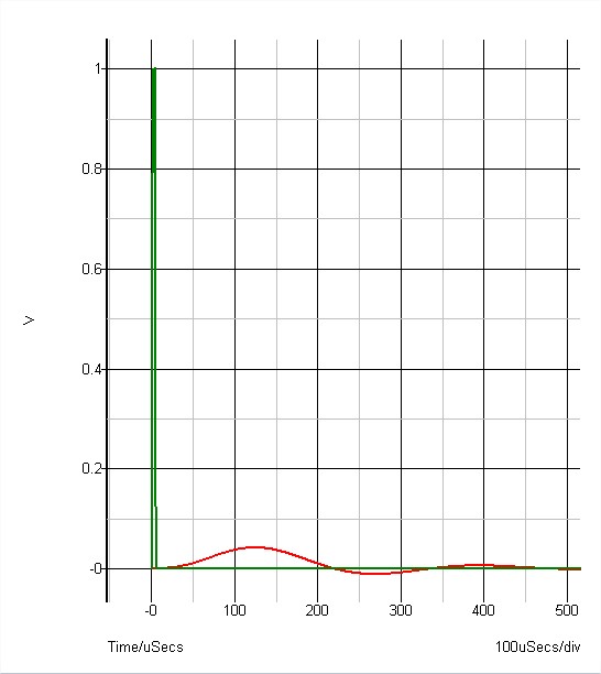

    Apropos den "korrekte impulsgjengivelsen" fra DSD: Her er en 3 us firkant før og etter den har gått gjennom et analogt førsteordens lavpassfilter ved 40 kHz. Det er det mildest tenkelige analoge filter på utgangen fra en SACD-spiller. Da antar vi at step'ene blir perfekt gjengitt fra det digitale mediet (ubegrenset båndbredde), men se hva som skjer når ultrasonisk støy filtreres bort etter D/A-konvertering og den "perfekte" impulsen sendes videre til forsterkeriet:
    Da er plutselig ikke den impulsgjengivelsen så perfekt lenger, merkelig nok. De skrå flankene på det opprinnelige signalet skyldes tidsoppløsningen i simuleringen, egentlig er de vertikale.

    We are firmly in favour of option 3, so long as packing (lossless compression) is used and the options for full surround are not ignored. Although many sophisticated schemes can be considered for downmixing matrices operating in the players, this strategy will always lead to more working difficulties in production and in replay-hardware design.
    However, option 2 remains useful when minimising audio data rate is paramount, as in the case of sending three or five high-quality audio channels with MPEG-2 video."
    Hvor mye vil eksempelvis option 3 gå utover oppløsningen til 2 kanalssporet på en SACD på 60 min musikk?
    Vil man få full frekvens og dynamikkpå det sporet?
    Edit sikter til høykvalitetsporet og ikke redbooksporet.
