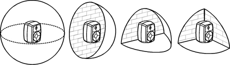

    Slettet siste innlegget - det ble selvfølgelig bare rør - fikk litt bein på kjøttet fra Genelec's sider;
    Radiation Space in a Room
    Because the space has a strong effect on the radiation, it is important to understand the initial conditions. The radiation space is typically characterised by a rough estimate of the solid angle (part of a sphere) into which the loudspeaker is radiating (see below). As the loudspeaker- subwoofer is driven, it creates a certain volume flow, which naturally spreads into all directions. When the space seen by the loudspeaker is limited and at the same time the total power is kept identical, the energy density (intensity) in the limited radiation space increases. Hence, reducing the radiation space increases Sound Pressure Level (SPL). Every halving of the radiation space doubles the SPL.
    Spherical loading
    Free-space (4pi)
    Free-standing
    Hemispherical loading
    Half-space (2pi)
    Flush-mounting
    2 walls loading
    Quarter-space (pi)
    Floor / wall
    3 walls loading
    1/8th-space (pi/2)
    Floor / 2 walls
    Concerning the usual placement of a loudspeaker/subwoofer, we notice that:
    · Against one solid boundary, which is large compared to the wavelength, the radiation space is 2pi, and the theoretical amplitude gain is +6 dB at low frequencies. This applies typically to flush mounting.
    · A subwoofer is typically placed on the floor and against a wall, hence we get two boundaries, and the radiation is now into the solid angle of pi, and the amplitude gain is +12 dB.
    · If a loudspeaker or a subwoofer is located in a corner, on the floor, the radiation space is again halved (pi/2) and the amplitude gain is then +18 dB.
    It is essential to note that in this context words like ”large”, ”close”, etc. always refer to the wavelength. ”Large” compared for example to 10 m (34 Hz) is different from ”large” compared to 3.4 m (100 Hz) or 3.4 cm (10 kHz). This means that when a loudspeaker is placed ”far” from boundaries at, say, 150 Hz, it probably is very ”close” at 30 Hz.
    Vis vedlegget 319379
    Spherical loading
    Free-space (4pi)
    Free-standing
    Half-space (2pi)
    Flush-mounting
    2 walls loading
    Quarter-space (pi)
    Floor / wall
    3 walls loading
    1/8th-space (pi/2)
    Floor / 2 walls
    Enkelt og greit fremstilt av Genelec. Ha med deg at også de beskriver helt ideelle forhold.
