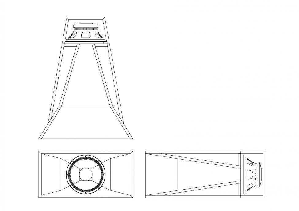

    [QUOTE = OB-BB; 1897926] Wait for items from the 18-Sound, it looks like Horn drawings are finished, so we'll see if the artistic freedom ends in a random stab in the back ...... BB [/ QUOTE]
    Beautiful drawings. One thing: where you see space between the outer walls and the inner walls add a plywood brace in the center of the panel running throat to mouth. I can't wait to read your listening impressions. I hope they sound fantastic! :)
    Oh, keep the compression chamber side walls at an angle on all four sides if possible. Other than that, your horn looks extremely interesting.

    Thank you - I was quite anxious to see if you'd comment the changed with/height ratio inside the mouth of the horn and had planned to to do just a pair of the Tuts (North-Norwegian for horns) for testing, but made the decision to make all four in the same batch. Hope this ratio-deviation won't be an issue.
    I plan to fill the hollows with expanding polyurethane foam in order to keep resonances under control. As you can see by the last picture, I have made another major change compared to your designs - I have chosen to use MDF(!!!). This design will have very few/small unsupported areas and I assume this choice will make few issues and as most of the horn will have a painted finish (except the horizontal planes inside the horns that will be mahogany- or walnut-veneered) it will be easier to achieve the expected finishing grade.
    I will follow your advise regarding the back-chamber - this is a pre for the overall construction as this also will increase the mass in a critical part of the horn.

    Så sluket lenger opp reagerte litt på kompresjonsforholdet i ditt nye hornprosjekt, det er jo et interessant spørsmål , hvor mye kompresjon kan vi ha ? er kompresjon betinget av membran type/ rigiditet , er erfaringer med slobs overførbare - hvilke andre faktorer er bestemmende for komp.forh. megnetstyrke ? ja vet noen noe helt sikkert om dette ? Har noen gjort praktiske sammenlignbare forsøk ?

    Som det meste jeg holder på med, handler dette også om å prøve og feile, litt som å stå i nærheten når det smeller og prøve å forstå hva som hendte. Mange nok ganger har jeg vært den som har stått nært nok og ikke hatt filla peiling på hva som traff meg.
    Tipper (uten å vite det!) at Slukos reaksjon var basert på at dette er en åpning man heller finner igjen på noen tøffe 10" mellomtonekonstruksjoner enn det som brukes i mellombassen.
