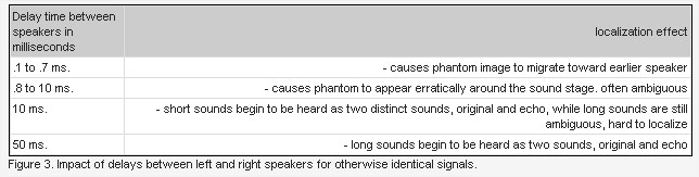

    En av artiklene jeg linket til på forrige side mener at 7 dB nivåforskjell er tilstrekkelig for å få phantom image til å snappe over til en av høyttalerne.
    Then, a little later still, I got into some loudspeaker research, and found myself called upon one day to make a research recording, wherein I recorded a batch of clicks with very carefully documented changes in level between the stereo channels. This was one of those cases where I figured I knew what was going to happen before I started. Given my golden ears, there just wasn’t much doubt that I could hear the image move as soon as I tweaked the pan-pot even a little, so I decided to calibrate the changes to 1/10th of a decibel, so that I’d be able to really pick out the subtle differences in localization that were going to happen when the levels between channels changed. However, I was very startled to discover that the phantom image didn’t seem to move at all even when the levels between channels changed a whole decibel! I was so startled that I became positive I had made a mistake when preparing the tape! A little investigation (well, about three hours, including chasing down all the wiring in the monitoring system!) showed me that I hadn’t made a mistake, and when the dust finally settled I had found out something quite interesting: that as long as the difference between channels is less than 3 decibels, the phantom image hovers pretty much in the middle point between the two speakers. I promptly ran this down to my buddies at the local loudspeaker factory and we tried it in the anechoic chamber with blindfolds and people pointing at the imaginary phantom, and it still remained true: with up to 3 dB difference between channels (that’s half-power, remember!) the image didn’t move much, maybe five degrees. With between 3 and 6 decibels difference in levels, the phantom quickly and without much stability migrated to the louder speaker, hovering just inboard of that speaker, and once the difference was greater than 7 decibels, the phantom was for all intents and purposes coming from the louder speaker.
    So, once again, I’d fooled myself, and had some new stuff to learn and think about. The principle of mixing I’ve evolved from this (not very profound, I’m sorry to say) is that there are only three panning positions: Left, Center and Right. Within those zones, the pan-pot yields a little sense of localization shift, but mostly it isn’t stable and moving my head by an inch or so screws it up. It isn’t very reliable and I can’t count on that localization detail being there in playback away from the studio.
    Moulton Laboratories :: Principles of Multitrack Mixing: The Phantom Image
    I tillegg kan man selvsagt fikle med tidsforskjellen mellom høyttalerne, og der skjer ting ganske kjapt:
    Moulton Laboratories  Principles of Multitrack Mixing The Phantom Image - Google Chrome.jpg
    Når så små tidsforskjeller som 0,1 ms påvirker plasseringen av stereobildet, tyder det på at to høyttalere som skal gjengi et stereoperspektiv være godt matchet i fasegang. Det kan fungere selv om begge høyttalere har samme avvik i frekvens- og fasegang, men hvis de har ulik fasegjengivelse/gruppeforsinkelse er det kjørt. Det har fint lite med ledninger å gjøre, forresten, men en god del med komponenttoleranser i passive delefiltre og tidlige refleksjoner fra møblement inntil høyttalerne. Lyden går som kjent 34,4 cm på ett millisekund.
