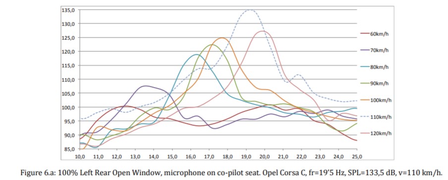

    Noen har selvsagt forsket på effekten av å kjøre med nedrullet sidevindu i forskjellige hastigheter med biler av forskjellig størrelse:
    https://asa.scitation.org/doi/pdf/10.1121/2.0000097
    When a back window is 25% open the buffeting noise is not perceived; it starts to be perceived when the
    window is 50% open, with a resonance frequency of 15.6 Hz at a speed of 80km/h, but is not irritating
    because the pressure level is low (110.2dB). When the window is rolled down at 75%, two airflows
    appear inside the car: one from the top of the upper interior zone and a second one from the central
    interior zone. The effect of buffeting noise is then clearly perceived with a resonance frequency of 16.4Hz
    at a speed of 80km/h and a pressure level of 119dB, increasing to 19.5Hz for a speed of 110km/h and a
    pressure level of 122dB. At a speed higher than 130-140km/h, the buffeting noise disappears, depending
    on the car model. For Opel Corsa the effect of buffeting noise appears only in one speed range, while for
    Peugeot and BMW models three different speed ranges are identified: for generation, persistence and
    disappearance of buffeting noise.

    DSP gjør kraftbehovet mindre fordi man deler det opp og bruker mye effekt der det behøves, fortrinnsvis i bassen.
    Jeg kjører 4- veis i min DSP setup, og bruker flere hundrede watt til bassen.
    De øvrige 3 delinger får sparsommelige 25 watt hver seg, men trenger ikke så meget, da de alle tre haver godt over svimlende 100 dB følsomhed.
