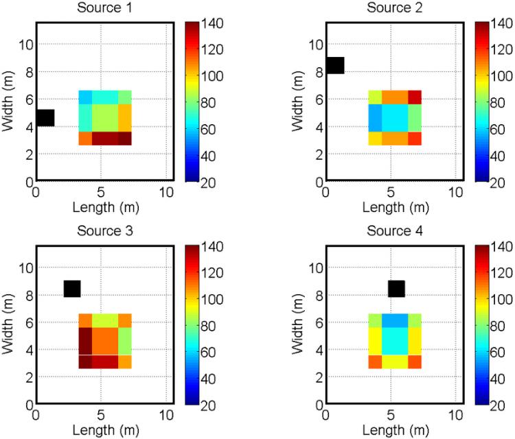

    En interessant artikkel:
    https://www.researchgate.net/public...ation_as_a_function_of_closed_acoustic_spaces
    This initial work towards a clear answer to the question of low-frequency localization puts forward a hypothesis that the lowest localizable frequency in a closed space is dependent on a number of variables including: room dimensions, source location, listener location and reverberation time.
    While the localization methods discussed in section 2.1 are largely accepted as correct, there are varied viewpoints concerning the localizability of low-frequencies (subwoofer band, typically below 120 Hz). A thorough literature review was conducted by the authors in a previous paper14 which indicated a nearly even split between those who believe low-frequency localization isn’t possible or important2-7 and those who think the opposite8-13.
    Initial work focused on eliminating this ambiguity looked at the amount of uncorrupted localization time (time a listener receives direct sound only) at various locations in different two-dimensional spaces. Corner and front wall midpoint source positions were examined. The resulting rough hypothesis suggests that listeners require approximately 1.4 uncorrupted wavelengths of a given frequency for accurate localization and that position and room size were crucial factors determining the number of uncorrupted wavelengths received14.

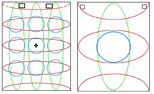

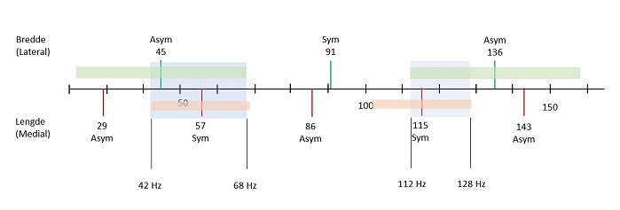

    samme fenomen. I rom er det ikke så enkelt, men med en gammel metode kan man altså forutsi resultatet i ulike rom.
    Mitt rom er 6 meter langt og 3,8 meter bredt og har følgende rommoder i bredde og lengde.

    Her er det mye informasjon, men resultatet er at jeg forutser at rotasjon eller retning kan høres i to områder når anlegget
    konfigureres som vist under. I området 42 til 68 hz og 112 til 128 hz vil man kunne høre dette i senter av rommet (innenfor
    blå ring). Lyttertest på frekvenssveip med +2hz bekrefter dette. Forutsetningen er at høyttalerne står plassert som vist. Om
    de plasseres innenfor grønn merking så kan ikke differansesignalet drive moden siden man befinner seg i trykknull (trykkets
    gradient). Bildet nedenfor viser forhold ved øverste frekvensbånd (112 til 128 hz) og det laveste frekvensbåndet (42 til 68 hz).
    Siden lytterommet er en stue kan jeg ikke plassere høyttalerne helt ut til sidene. Jeg hadde på forhånd funnet noen gode
    plasseringer litt innover. Faktisk viste forsøkene at jeg måtte endre litt på plasseringen siden de nok lå litt innenfor eller i
    berøring med grønn merking. Veldig bra resultat når jeg spilte musikk etterpå.
    Jeg hørte også noe bevegelse mellom de to frekvensbåndene. Må forske litt mere på dette, men rommet har litt «vorter» og
    en ganske stor åpning inn til en åpen trappegang. Uansett er det positivt.
    En analyse av kvistrommet vil nok ikke bli like bra, mitt andre lytterom.

    40.469
    43.802
    Enig i at det er svært ulikt i lytterommet og utenfor i det fri. I det fri har vi trykk og hastighet samtidig. I rom må vi "skape" sideveis hastighet i jungelen av noder siden vinkelen er 90 grader. Interessant link om direktekomponenten og 1. refleksjon. Det er nok her horn og slikt kommer inn som en forbedring. Det rommet vi skaper sideveis stammer fra differanse signalet og kan sammenlignes med to egne høyttalere (subber) på sidene sånn konseptuelt.
    NB. Har ikke bruker på researchgate, så leste bare dine klipp.
    Du kan jo sjekke denne om du har bruker hos AES AES E-Library » The Impact of Decorrelated Low-Frequency Reproduction on Auditory Spatial Imagery: Are Two Subwoofers Better Than One?
    Det kan også være interessant å se hvilke frekvenser som anses «localizable» i et lytterom av noenlunde overkommelig størrelse. Fargen indikerer laveste lokaliserbare frekvens i Hertz, ref skala på høyre side:
    Det estimatet forutsetter at man trenger 1,4 perioder «arbeidsro» til å dekode retningen. Lytteforsøkene i linkene viser at det er heller optimistisk, og tyder på at man snarere behøver ca 1,8 perioder med direktelyd før første refleksjon treffer. Gjør gjerne et overslag på hvor stort lytterommet må være for å kunne retningsbestemme f eks 50 Hz. :)
    https://www.researchgate.net/public...SOURCE_LOCALIZATION_IN_CLOSED_ACOUSTIC_SPACES
    Dette handler forøvrig fortsatt om tids- og faseforskjell i trykkbølger, og har fint lite med partikkelhastighet å gjøre. Vi kan ikke detektere partikkelhastighet direkte. Men lydbølger består fortsatt av både trykk- og hastighetsvariasjoner, både inne i et reflekterende lytterom og ute i det fri. Hvorfor og hvordan skulle det være forskjellig?
