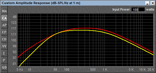

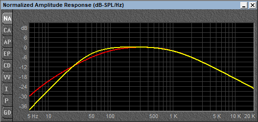

    Hello Elvind,
    Thank you for the email. We have many people asking this question. To answer the question first requires a little further evaluation of the SLOB design. The intent of the SLOB is to increase the acoustic loading on the woofer, allowing non-ideal woofers to be used in an OB alignment. This has two effects. First, it reduces the upper end efficiency, which increases the apparent extension of the system. This does not increase the low end efficiency, only reduces the upper end efficiency. Secondly, it increases the resistance which will raise the Qts of the driver. The drawback is lower efficiency, resonances from the slot, and still a need for significant power to move the woofers to high excursion.
    To give an idea, if we look at the Altec 416-8B as an example we can see the effects of adding the slot loading to increase apparent mass and suspension stiffness. In the Normalized amplitude Response, the red curve is the driver natural response. The yellow is with the slot loading. Definitely an increase in extension.
    Inline image 1
    However if we look at the amplitude response with 100W input, we see that there are no actual gains. There is further loss of both low end and high end efficiency. This is the case with any slot loaded open baffle type designs. What this model does not show are the further resonance issues that would be added to the yellow curve based on the size of the slot.
    Inline image 2
    For open baffles to really work well and have deep extension, the woofers need to be designed with proper motor strength, soft suspension, and ideal parameters. Here you can see how the Dipole15 without any loading compares to TWO 416B in a slot loaded design. For subwoofer use, everywhere below 40hz, the single Dipole15 significantly outperforms the pair of 416B in SLOB design. By 20hz, the Dipole15 is over 5dB more efficient. With the high 15mm one way Xmax, it also produces 6dB more output than the pair of woofers.
    That all said, if you really have your heart set on a SLOB type design, you need a woofer with lower Qts and more efficiency that will end up with a Qts between .5 and 1.0 when being slot loaded. You don't want to end up with a Qts that is far too high. The TD15H would be the best option in this alignment. With 14mm Xmax you can still get significant output from the design. With all SLOB designs, make sure you have good power behind this and you will also ideally want EQ to boost the low end.
    However, if you are looking for a subwoofer solution that extend very deep without need for EQ and with minimal power, the attached U baffle design would do far better. It requires far less power on the low end. This will also be free from resonances caused by the slot and can play much higher in frequency if needed.

    Hello Elvind,
    Thank you for the email. We have many people asking this question. To answer the question first requires a little further evaluation of the SLOB design. The intent of the SLOB is to increase the acoustic loading on the woofer, allowing non-ideal woofers to be used in an OB alignment. En veldig bastant ANTAGELSE, som ikke er det JEG har lagt til grunn for konstruksjonen. Jeg begynte med å finne en EGNET driver som kunne tåle julinga og den spesielle belastningen som de blir utsatt for i denne konstruksjonen. This has two effects. First, it reduces the upper end efficiency, which increases the apparent extension of the system. This does not increase the low end efficiency, only reduces the upper end efficiency. Secondly, it increases the resistance which will raise the Qts of the driver. The drawback is lower efficiency, resonances from the slot, and still a need for significant power to move the woofers to high excursion. Igjen, teoretiske antagelser som ikke nødvendigvis er slik i virkeligheten. Her handler det om skalering. Og slot resonans er ikke et problem så lenge en vet hva en driver med.. PÅ MINE SLOB er det en liten peak å spore rundt 360-370 Hz - den er enkel å hente ned dersom behov, og derfra er det spikrak kurve opp til ca. 1k. Men dette er irrelevant da et slikt system normalt ikke skal brukes høyere opp enn kanskje max. 200 Hz. Significant Power? Vel, 50W kan kanskje kalles det - dersom en roter rundt med 5-6 rørwatt til daglig, men i dagens kilowatt kappestrid på forsterkerområdet så burde han da ikke bekymre seg om det? 50 W tilgjengelig pr. kanal klarer fint å overgå konsertnivå hos meg, neste stopp er ubehag i mageregionen og fortsatt er det mer å hente UTEN hørbar distorsjon. "High Excursion?" Igjen et ikke-tema hos meg, Ved 100 dB i lytteposisjon er det så vidt det dirrer litt i membranene. Og ikke glem at slaglengde IKKE er noe vi ønsker oss selvsagt, med alt hva det innebærer av EMF og termisk kompresjon etc. etc.
    Inline image 1
    However if we look at the amplitude response with 100W input, we see that there are no actual gains. There is further loss of both low end and high end efficiency. This is the case with any slot loaded open baffle type designs. What this model does not show are the further resonance issues that would be added to the yellow curve based on the size of the slot. Han VET ingen ting om ev. resonanser. Og hvorfor er han så opptatt av redusert effektivitet? Når et bassystem er godt på den hyggelige siden av 100 dB/1m. helt ned til 30 Hz så er ikke effektiviteten noe problem heller. Try before cry er mitt mantra.
    Inline image 2
    That all said, if you really have your heart set on a SLOB type design, you need a woofer with lower Qts and more efficiency that will end up with a Qts between .5 and 1.0 when being slot loaded. You don't want to end up with a Qts that is far too high. The TD15H would be the best option in this alignment. With 14mm Xmax you can still get significant output from the design. With all SLOB designs, make sure you have good power behind this and you will also ideally want EQ to boost the low end. Vel, igjen - dette er bygget på teori og overføring av kjent OB design til SLOB. SLOB er IKKE det samme som en vanlig OB konstruksjon. For the record, jeg har INGEN EQ i systemet mitt, heller ingen DSP. Flatt til 32,5 Hz og pen avrulling ned til16.
    Best Regards,
    John
    All in all, et svar som forventet fra en produsent. Ikke verst bare å få et svar, og rimelig godt begrunnet og forklart også. MEN - dette er ut ifra et klassisk ståsted hvor de tradisjonelle OB løsningene legges til grunn. Det finnes en annen verden utenfor den sfæren, men det krever litt å ta seg dit.Det er f.eks. åpenbart at han ikke kjenner til FORDELENE med en SLOB konstruksjon som dette, hvorfor vi gjør det liksom. AND who could blame him. No use flogging a dead horse!
