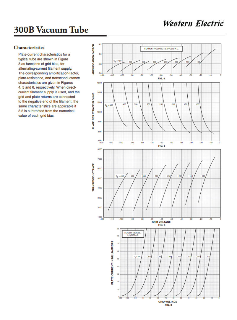

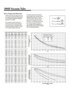

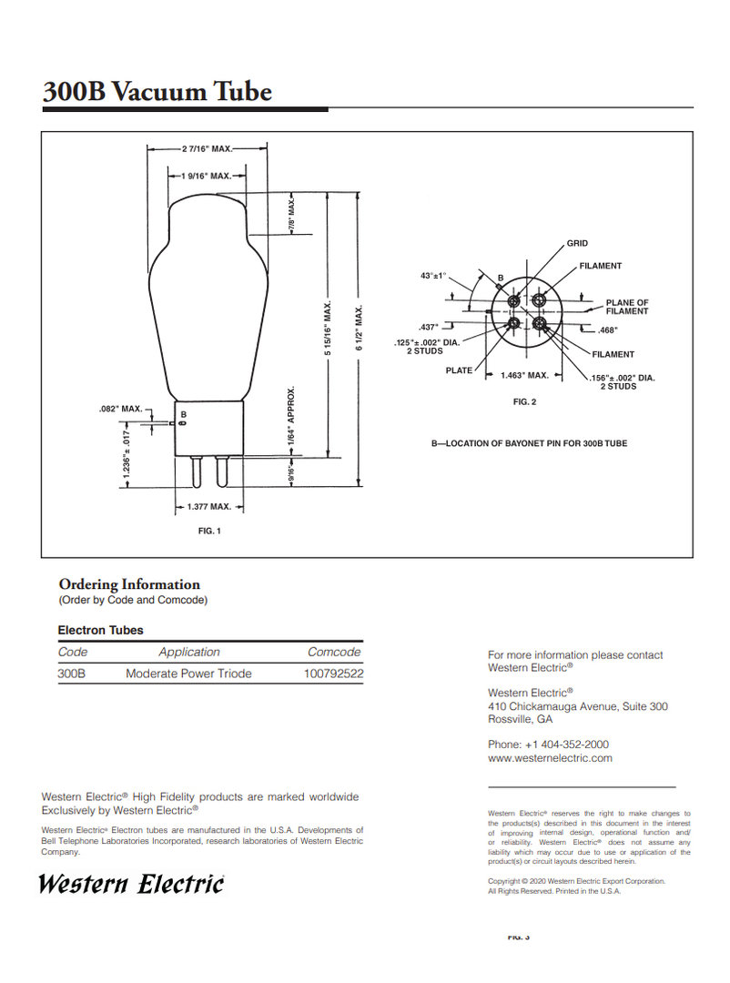

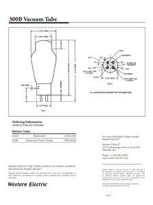

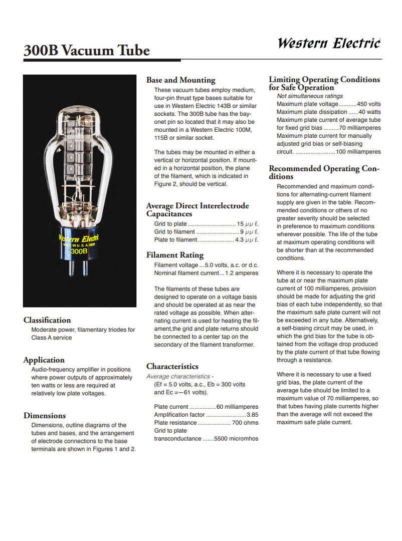

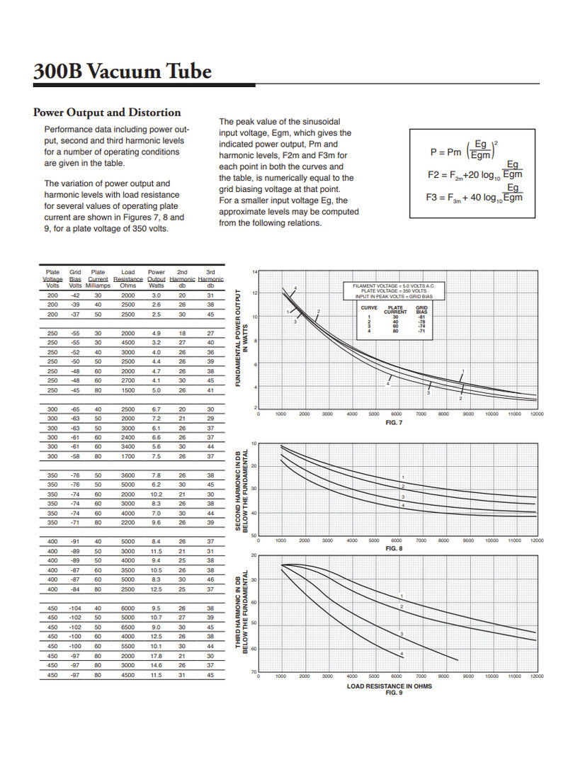

    God start for de som ønsker å lese seg litt opp på Vacuum Tubes Versus Solid-State
    Saksa ut utdrag fra linken over:
    linear [triode] vacuum tubes have lower overall distortion than bipolar transistors or FETs, and the distortion products are primarily lower-order...the clipping characteristic of tubes is actually not much softer than transistors, but feedback tends to 'square-up' the clipping. Thus, the heavy feedback in most solid-state designs gives them worse overload performance.
    "A low- or no-feedback design can be driven harder without audible distortion," Atwood continued. "High feedback also can lead to transient intermodulation distortion (TIM), caused by clipping or slew-rate limiting within the feedback loop." See following table for a comparison of the attributes of tubes and transistors in audio applications....artikkel fortsetter på denne
    linken
    Mange tror rør er magi, men tvert imot...det er faktisk vitenskapelig teknikk basert på målinger(ingeniørkunst)! :cool:
    Long live The tubes!
    linken
    Vis vedlegget 707846 Vis vedlegget 707847 Vis vedlegget 707848 Vis vedlegget 707849
