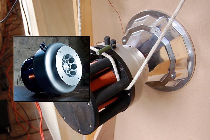

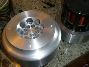

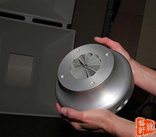

    Apropos carbon i drivermembran, amerikanske Cogent satset friskt på dette i sine egenutviklede drivere.
    De lagde to modeller, DS1448 og DS1428, field coils begge. Herlig maskinering!
    Kjenner folk som hørte dette da det ble introdusert, ikke spesielt bra etter hva jeg skjønte. Særlig den større
    driveren for de laveste frekvensen låt mystisk. Håper de har fått ordnet dette etterhvert, interessante saker egentlig.
    Hadde en del kontakt med de for ti år siden - her er litt info;
    Hello Jan,
    Thank you for your inquiry into the Cogent DS1428 drivers.
    I have two pair left for sale. The price is $15K per pair. These are new, never used, in the box.
    The story behind Cogent is complex. The drivers were extremely expensive to manufacture, as the phase plugs alone require 9 hours each on a wire EDM machine. More problematic, Cogent did not have a business plan for including the drivers into a finished system. OMA did, and produced the AC2 speaker using the Cogent DS 1428, and will be announcing the new Imperia 4 way system using these drivers, in the next month or two. The great advantage of the Cogent, is the very high bandwidth of the driver compared to typical metal dome diaphragm compression drivers, and that it is the only ground up field coil compression driver made in the world today. All others are merely retrofits of pm drivers with field coil motors attached. The new Cogent phase plug extends the frequency range of the original RCA MI 1428 driver by several octaves, for example.
    Spare diaphragms are readily available, though it is virtually impossible to destroy one in typical usage.
    Cogent will produce drivers in the future, but until they decide how to expand their model, OMA is the only company I know using Cogent.
    Please let me know if you would like more information.
    Her er de - DS1448 er de store;

    Feite drivere!! :)
    Dem hadde vel fortjent noen bedre horn enn dem sammenlimte koniske ispinnene.
    2360 står alltid klar for testing av nytt... dem er vel billige på ebukta dem driverne... kremt :D

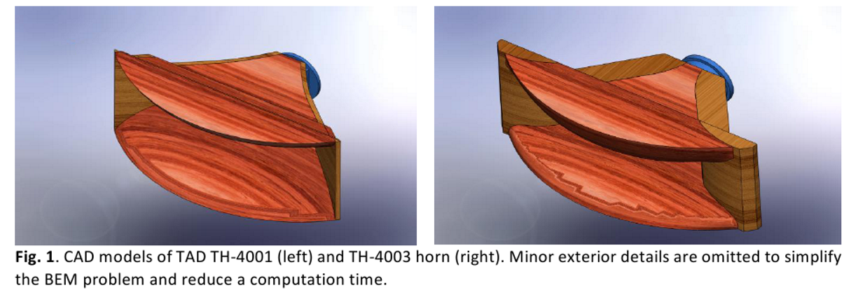

    En fysiker som simulerer TAD TH-4001 og TH-4003 leter etter bilder av interiøret i TD-4003 fra forskjellige vinkler, foretrukket laget med en linjal for å lage 3D CAD-modell i skala.
    Kanskje noen her allerede har laget noen bilder, eller til og med en 3D CAD-modell?

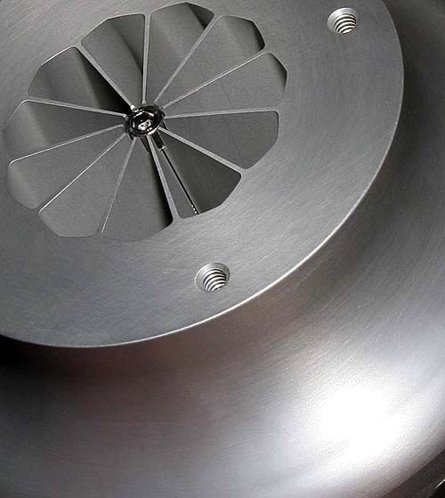

    Jeg har tenkt en del på cmcd-driverne. For dem som ikke kjenner dem, det er vel typisk 6,5 og 8" papir conr drivere fra JBL med single slot faseplugg og 4" exit. Jeg tenker single slot faseplugg ødelegger moroa fullstendig. Det burde være mulig å lage en slik driver som fungerer fjell ned til 80 Hz og allikevel har båndbredde til godt over 1kHz uten at det hele roter så voldsomt i tidsdomenet. Men jeg tror man bør tenke radial faseplugg og ringradiator for å få det virkelig bra til.
    Snickers-is
    05.02.2004
    18.602
    17.314
    Da er jeg blitt korrigert, CMCD har 3 slots. Uansett, ser vi på Vente og Thuras-modellen har vi allikevel en heftig begrensning i HF. Avstanden mellom spaltene i Tonalab 289-driveren er under 5mm, mens her er det 3 spalter på en 6,5" membran, altså omkring 125mm, og da over 20mm i snitt mellom spaltene. Det betyr at om vi når 20k med 5mm burde vi kunne nå 5k med CMCD. Men så har CMCD en konsentrisk faseplugg som i seg selv har visse utfordringer sammenliknet med radial + ring. I tillegg har man ikke time aligned spalter, og som om ikke det var nok er membranen i papir, noe som gir riktig treg distribusjon mot spaltene. Oddsen er at dette forvrenger mye i tidsdomenet allerede mellom 1 og 2kHz, kanskje lavere. En halvbølge på tvers av membranen ligger ikke langt over 1kHz og om spaltene kan betraktes som kvartbølgeresonatorer betyr det at hver og en av dem har sine egne resonanser i området 1-5kHz. Det siste ville altså vært unngått om de hadde samme lengde og det ikke var noen distribusjon i tidsdomenet for inngangen til hver spalte.
    Kompresjonsdrivere, spesielt de med konusmembran og konsentrisk faseplugg slik som CMCD har et ekstremt komplekst mønster av resonanster. De faller til de grader innenfor det jeg beskrev i denne artikkelen:
