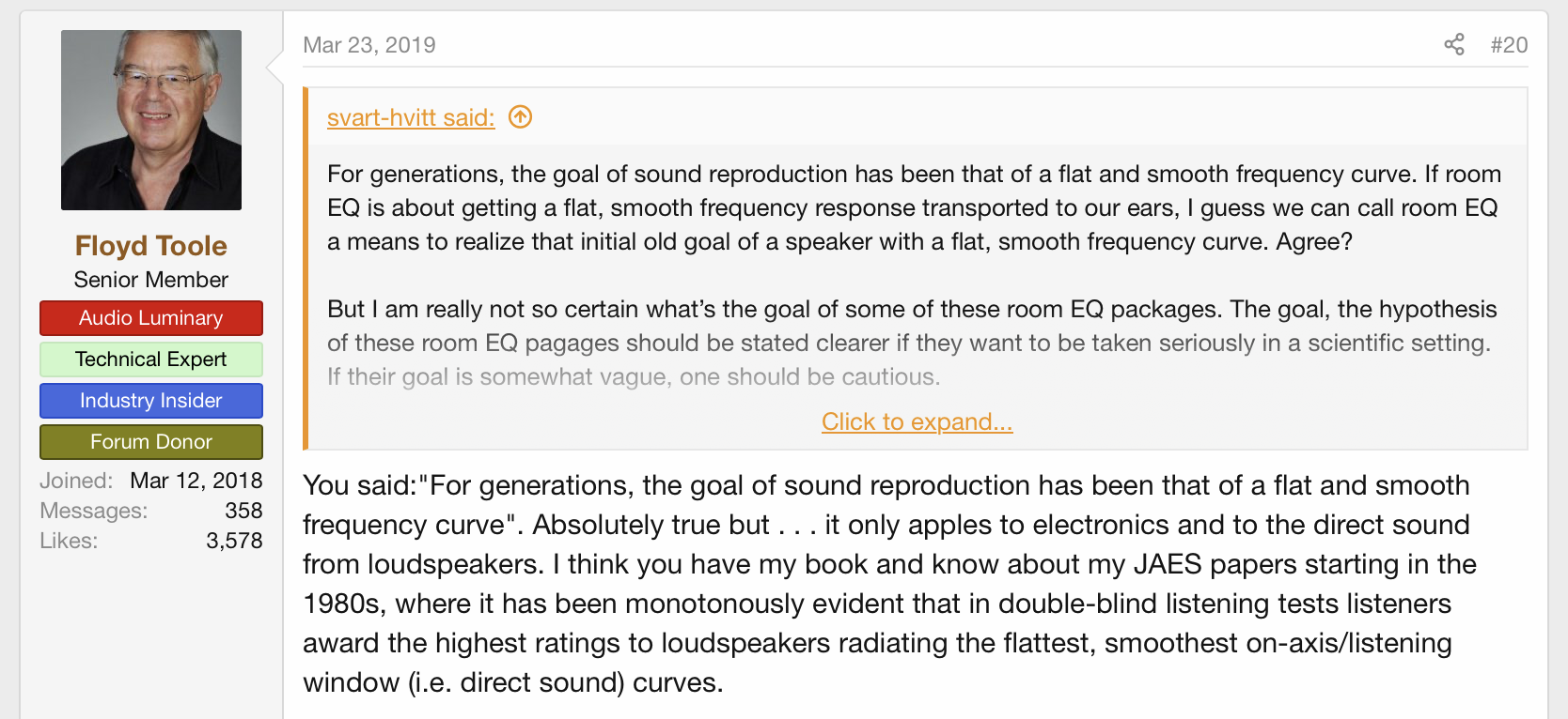

    Toole etter at svart-hvitt ble bannlyst fra ASR:

    Hele sulamitten i denne tråden er meget godt forklart av Toole i ASR tråden hvor Hvittingen troller i vei og tilsynelatende ikke forstår at han utfører et karakterdrap på seg selv. Jeg refererer under Toole sin generøst forklarende tekst (Aug. 2019):
    A preference for a downward tilting steady-state room curve is the result of two things:
    1. beginning with my very first double-blind listening tests in the late 1960s, through the detailed tests in my 1985-86 JAES papers, continuing to this date, the highest rated loudspeakers have had the smoothest, flattest on-axis anechoic response. This is the direct sound.
    2. The normal forward-firing configurations of drivers inevitably start out as omnidirectional at low frequencies, becoming progressively more directional at higher frequencies. The rising bass energy yields a steady-state room curve with a downward tilt.
    A fundamental problem has been the incorrect assumption, made long, long ago (in the age of RTAs), that the audio rule "flat is beautiful" should apply to steady-state room curves, not the direct sound. It corrupted the movie industry and its problematic "X-curve" (Chapter 11 in my book), and the rest of audio in its application to the ITU-R BS.1116-3 and EBU Tech 3276 standards, unfortunately still used by at least some. broadcasters and monitor manufacturers. Turning back the clock is difficult.
