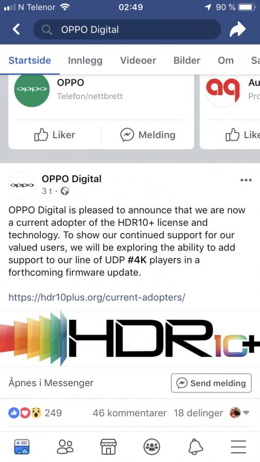

    "Oppo is on the verge of rolling out a key new update to its highly acclaimed UDP-203 and UDP-205 4K Blu-ray players that will enable them to play a new type of 4K Blu-ray picture format.
    While I’m still awaiting formal confirmation of the new feature rollout from Oppo, I now have it on good authority from two separate sources that the brand will be adding support for the HDR10+ HDR format to both of its much-loved 4K Blu-ray decks in the next few weeks. Either by the end of December, or the early part of January."
    https://www-forbes-com.cdn.ampproje...-blu-ray-players-to-get-surprise-new-feature/

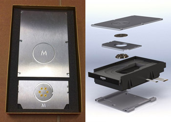

    Aluminium BD-ROM Stabilizer
    Har den noe for seg lyd/bildemessig? Eller er det kun at den skal bli ennå mer stillegående?
    Min er i utgangspunktet helt stille, så det er ikke ett behov for min del.
    Fikk satt inn en LPM modul (Lineær strømforsyning) i forrige uke, og det kan absolutt anbefales for de som ikke har gjort det.
