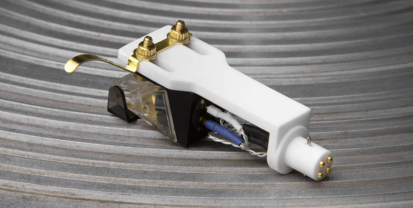

    Jeg har gjort en ting til: Monokoplet min AT-VM95SP:
    A stereo cartridge is designed to respond to both lateral and vertical modulation. If you play an Edison DD or other vertical modulation recording with a stereo cartridge and listen thru a full stereo playback system, you will hear the recording but the sound will be out of phase between the two speakers. This will sound strange with sound coming from the two speakers but no image seeming to come from the space between the speakers. If you play a lateral mono recording such as other typical 78rpm records on this same stereo system, you will hear the recording and the sound will be in phase and sound natural from the two speakers. This may be adequate if you are only casually interested in listening to the vertical recordings.
    In order to hear the sound of a vertical recording with minimum surface noise from the record, you need to combine the two signals coming from the cartridge into one signal. If you parallel- or series-connect the cartridge outputs, you will transform the cartridge into either lateral-only or vertical-only responding, depending on the particular connection. This will reduce the unwanted surface noise from the modulation direction that you don't want to hear.
    Parallel connection of the cartridge outputs such that you hook the + or 'hot' connections together and the - or 'ground' connections together will result in the cartridge becoming lateral-only responding which is correct for most 78rpm records. To make the cartridge vertical-only responding, connect the 'hot' terminal of one cartridge output to the 'ground' terminal of the other channel. Similarly, connect the other two cartridge pins together. Then use only one cable (not the original two) to carry the signal from the cartridge to the amplifier. If your cartridge has only three output pins, connect one side of the output cable to one of the 'hot' pins and the other side of the cable to the other 'hot' pin and remove any cable connection from the third pin. This will allow you to play vertical modulated records such as Edison DDs and Pathé Sapphire records with minimum surface noise created by the lateral direction.

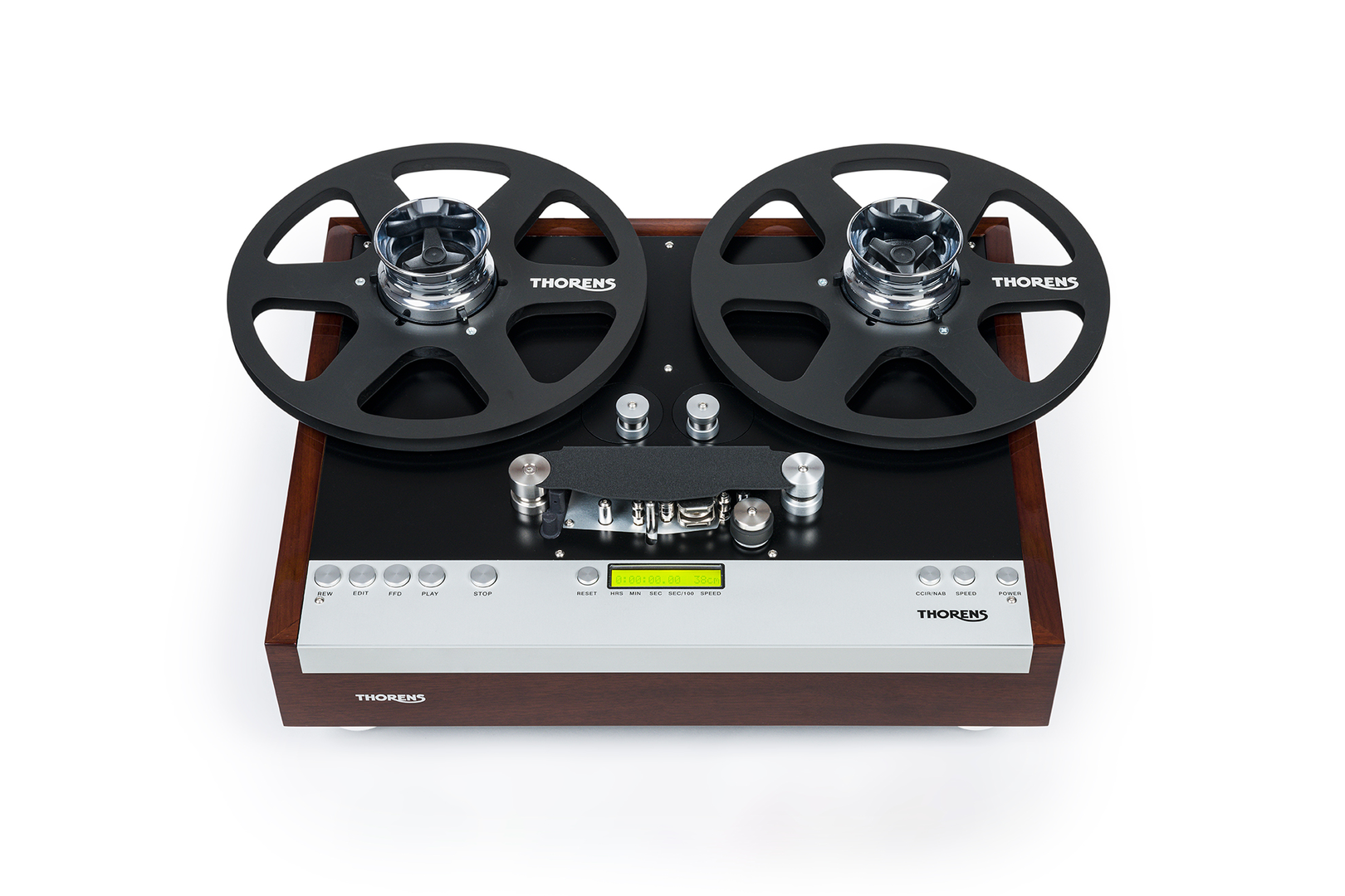

    Hadde vore perfekt match, potensial for uendeleg med fikling og supert for å signalisera til alle som kjem på besøk at du er hifigubbe.
    Dessutan har du sagt “aldri spoleband”, og det er fyrste steg i trappa.
    Edit: Ser no at denne er heilt ny. Ugh.
    J. Brünnhilde
    31.019
    26.564
    Og den koster € 12000. Alle muligheter for matchy-matchy i et smakfullt gulvlagt hjem når datter/svigerdatter er innom for å høre på - eh - kan vi håpe på Dylan?
    Gøy at det ikke er Thorenslogoer på noen av kabinettene på dette bildet. Reddet av Photoshop, for jeg tror ikke de har boret hull i gulvet for å få fram forsyningsspenningene. Fuglene må vite hvor phono- og hodetelefonforsterker har tatt veien.

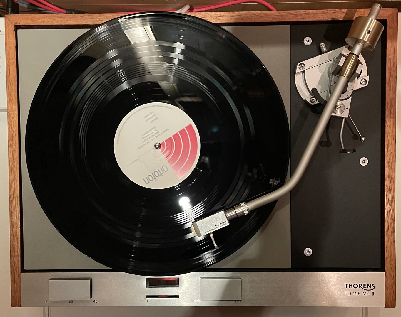

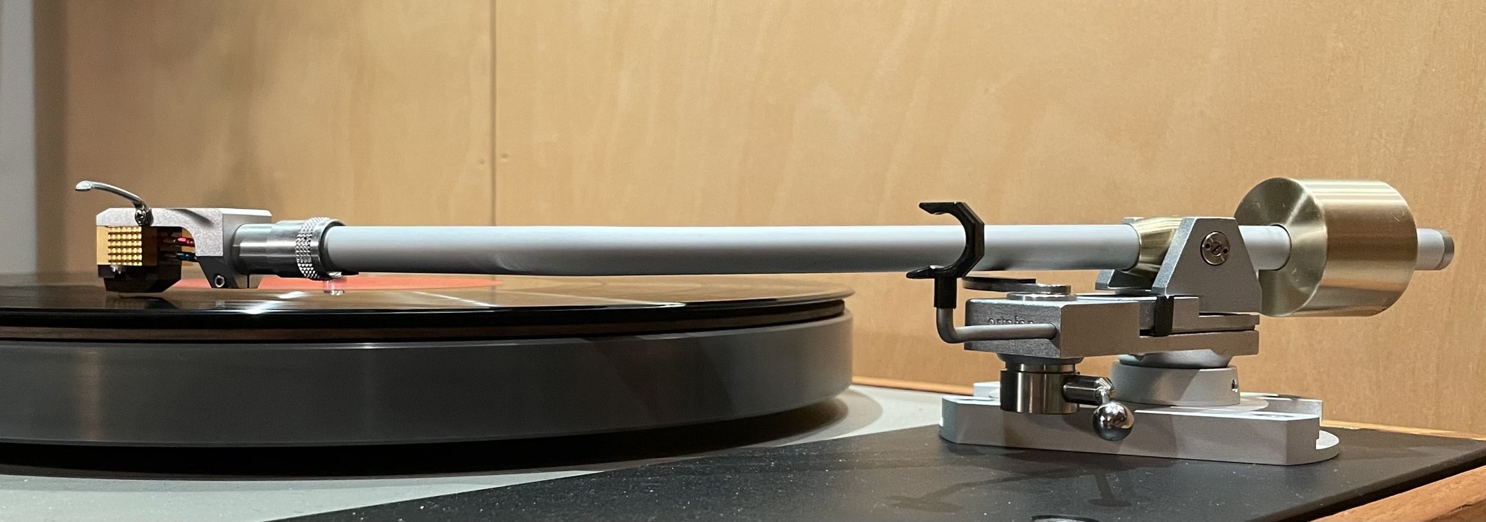

    Steike, den var lekker! Kler spilleren veldig godt!
    Hvordan låter det i forhold til gammel 309?
    J. Brünnhilde
    31.019
    26.564
    Usikker på hva jeg skal si. Er hodetelefonlytting nå i kveld, ikke kritisk. Låter solid, kan jeg si det? Intet bomkjøp.
    Men hvem bryr seg? Den modifiserte Jelco-løfteren med tynn betjeningspinne med kule på enden (Bokrand har laget en kopi av originalen) er så kul at det kan være det samme med lyden sånn til å begynne med.
    For trynefaktor alene vinner Alfred Bokrand over Thomas Schick på walkover.
    Thorens-avfjæringen trives bedre med Bokrand-Ortofon enn med SME 309 som er i grenseland tung.

    Vis vedlegget 888805
    Stort lengre arm får man ikke plass til på en 125.
    Det var vel ein “long”-variant (veldig fin) her i tråden for ei stund sidan. Men dette ser heilt fantastisk ut.
    Nesten litt leitt at eg har bestemt meg for at eg held meg til Rega-armen min til eg får bytta ut TD147-drivverket. Men, på hi sida, klokt og ikkje minst økonomisk.

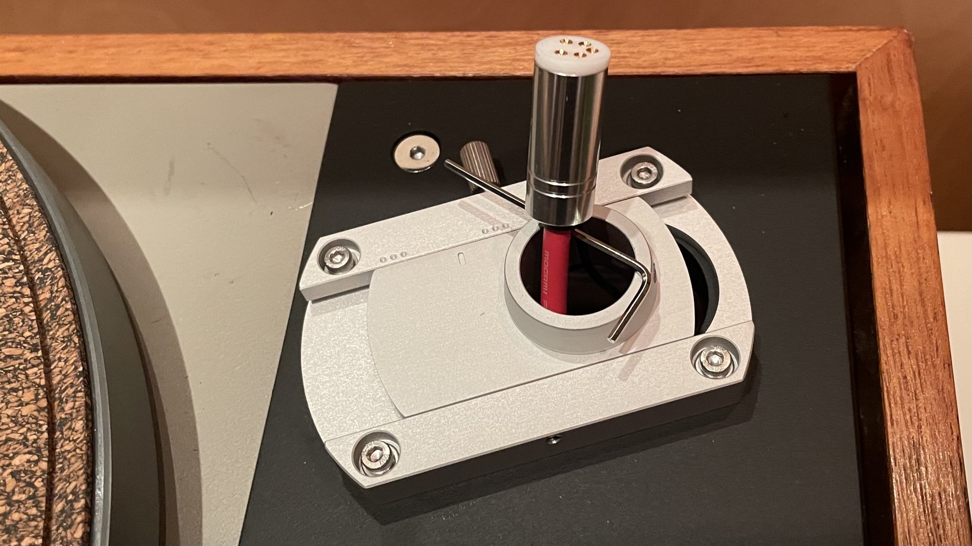

    Da kan jeg nevne at det sitter et par 125-prosjekter hos @Rogerk, hehe.
    Men ja, ser bra ut dette. Må bare låne en slik Doktor Fakeit-projektor hos nevnte herre. Det er noe jeg ikke får hodet rundt geometrimessig, så jeg må få målt P2S (armlager-spindel) ordentlig. Skal straks over med SME 309-en og også se TD160 Mk. II-eier @SiSt få hakeslepp over inventaret.

    Prøver å få hodet mitt rundt det jeg tror er en feil i dataene fra Bokrand (eller at han har bommet med armrørskrumningen). Oppgitt overheng og P2S (230 mm) stemmer ikke med Baerwald-geometri (66/120,1 mm null). Jeg får til Baerwald med å gå ned til P2S på ca. 228 mm og overhenget da opp 2 mm. Kjekt med vinyl!

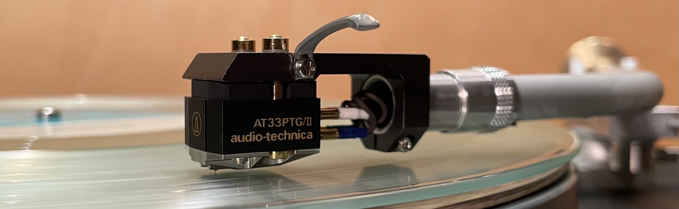

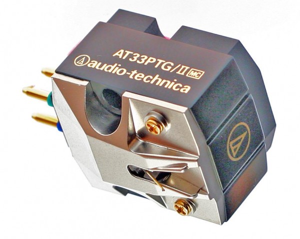

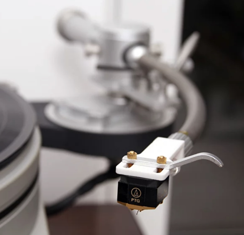

    Enig, men så kom jeg over dette bildet hos Alex Korf:
    Når man så vet at produksjonsutgaven av hodeskallet hans har fingerløfter i messing og at AT33PTG/II er midt i det søte punkt mellom pris og lydkvalitet får man nok en gang en påminnelse om at det å drive med grammofoner er et evig sluk.

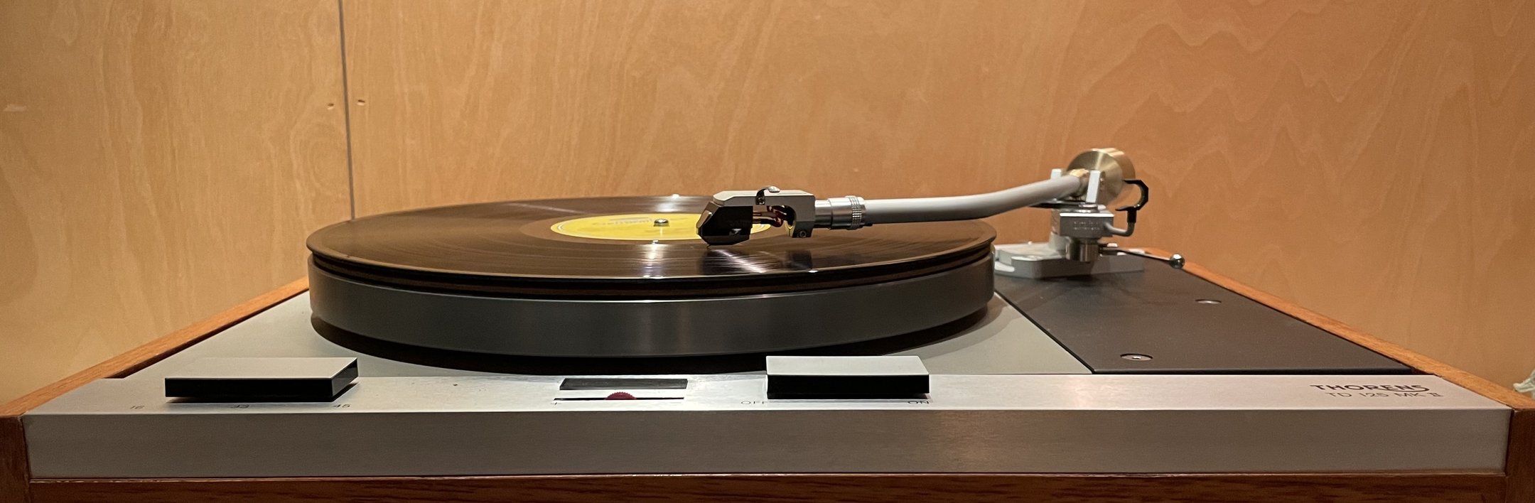

    Den berømte fyllecodaen i Soltis innspilling av Das Rheingold.
    Har puttet OC10en i det gjengede pickuphuset, mest fordi det er penere med alugrått pickuphus enn sort på Bokranden.
    Og ja det er Doktor Fakeit som titter frem oppe til venstre.

    ^ Den kombinasjonen av dD og Montana er verkeleg fin og velproposjonert.
    Er det dublett av HvK-LvB frå 1970-åra du har (heilt til venstre i platehylla i midten), eller er det fleire boksar i same serie/design?

    Takk. De står fint til hverandre uten å være like. Det var Jan Bakken i nåværende Bakken & Casey som laget dD-rammene og fikk dem lakkert av en ekstern leverandør på oppdrag av Ex-Syncrolux på oppdrag av meg (phui). Mine varmeste anbefalinger.

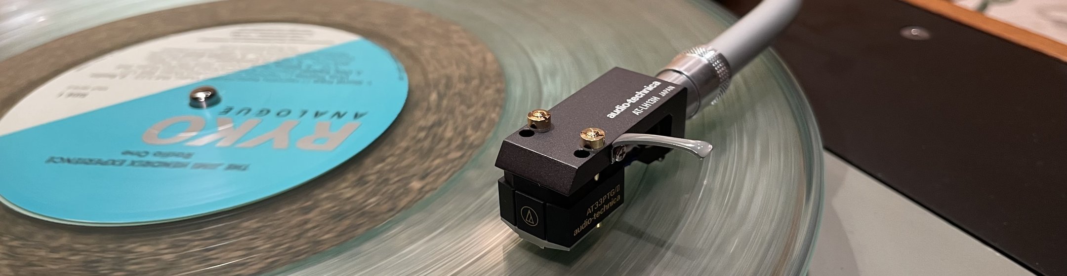

    Låter bra dette her. Hm.
    Ganske artig å tenke på at denne pickupen kom til meg brukt i 2007 via @impulse som forlengst har gitt oss opp.
    Når tørker en Audio-Technica opp mon tro?
    Musikken er nypressingen av Geza Andas innspilling av Mozarts pianokonsert nr. 21 KV467 «Elvira Madigan». Økenavnet har den fordi midtsatsen (fra denne innspillingen) ble brukt i den latterlig vakre filmen med samme navn.
