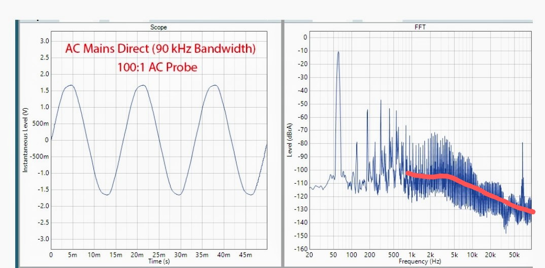

    Svært interessant lesning med mye referanse til Rønnberg .
    The Propagation and Interaction of Supraharmonics from Electric Vehicle Chargers in a Low-Voltage Grid
    During the measurements, another type of interaction between devices is observed in the form of “frequency beating” and intermodulation, in some cases resulting in the tripping of residual current devices. This interaction is further analyzed in order to better understand the possible impact it can have on the grid.
    On the other side, the immunity of end-user equipment to supraharmonic disturbances has already been studied to some extent [19]. Most electronic equipment uses EMC filters with capacitors to remove high-frequency noise from the input. However, capacitors absorb the high-frequency components as their impedance is inversely proportional to frequency according to
    with C being the capacitance and with the frequency f in Hz. This can lead to extensive heating and decreased lifetime (up to 40%) of those components, resulting in degradation of the equipment itself [20].
    Furthermore, (linear) load-flow models that are useful for modeling the behavior of “classic” harmonics are not accurate enough to model the propagation of supraharmonics because they are often not directly linked to the fundamental frequency and their behavior in grids is difficult to predict. Interaction between the grid and EMC filters influences the amount of current absorbed by other devices and changes resonant frequencies [21].
    2.2. Sources of Supraharmonics
    There are different sources of supraharmonic emissions. In general, all devices with converter-based power electronics emit supraharmonics to a certain extent, as an artifact of the conversion from AC to DC or vice versa. In this research, only the effects on the power quality at the AC side are presented. Nevertheless, effects on the DC side can be present but fall outside the scope of this research.
    By switching between grid and microgrid mode, the grid impedance Zg and background distortion in the voltage change. This can lead to a change in the emission of each connected device. Furthermore, it is assumed that the inverter impedances ZPV and Zbat are not constant for the different operation modes. This makes modeling difficult.
    For low-voltage networks, the resistance is dominating, especially close to equipment. Hence, for low frequencies (<2 kHz) it can be assumed that Zg is largely resistive. However, for higher frequencies the reactance of the cable will increase and can become dominant and the influence from impedances of neighboring equipment can play a role due to their capacitive nature.
    Adding extra devices will create a different impedance seen by the device and will possibly affect supraharmonic emission. However, it is important to note that for each frequency, this model has different parameters, as device impedances (often capacitive due to filters) and grid impedances (often inductive due to cable and transformer characteristics) change with frequency. By superposition of all individual harmonic load-flow models per frequency, the total supraharmonic emission to the grid from the system can be determined. In this linear model, no interaction between devices or other effects are included.

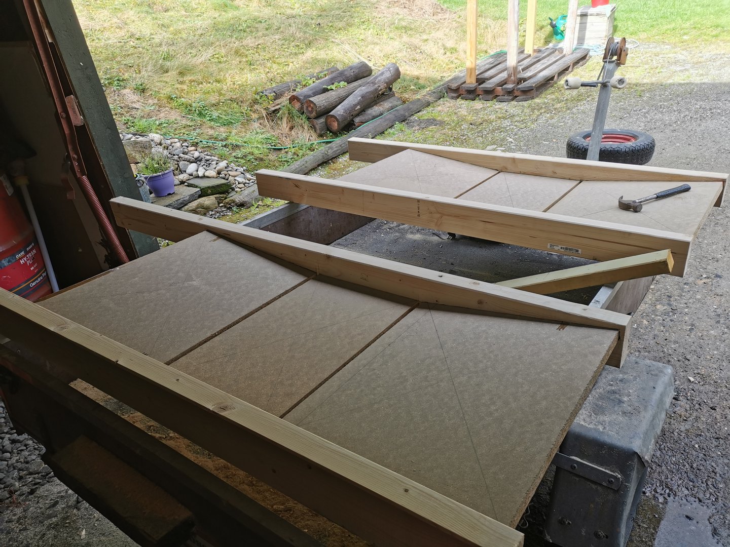

    Blyant, vinkel, metermål, linjal,
    Og noen plankebiter skal være nok til en duganes høyttaler sies det.
    Vel, i dag ble det målt og streket.
    Er jeg heldig så kan det bli lyd neste sommer,
    eller sommeren deretter 😛

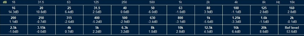

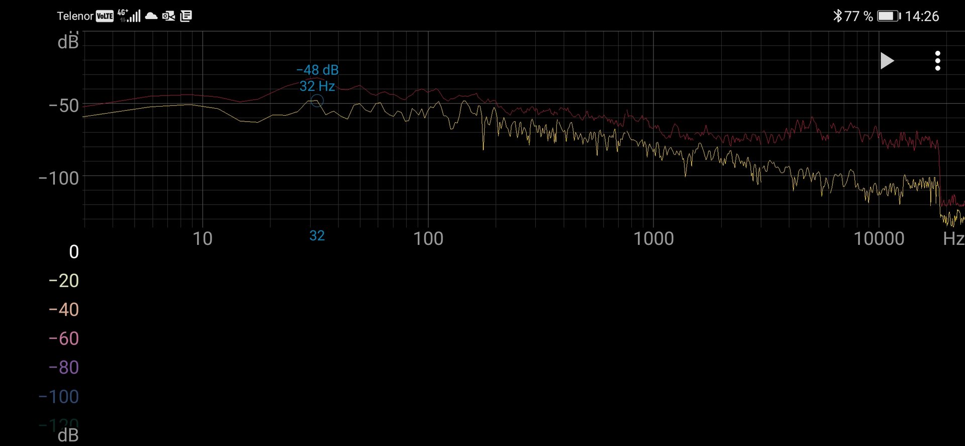

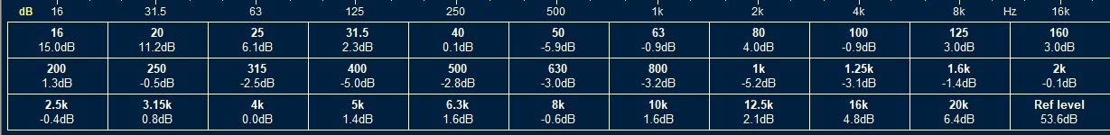

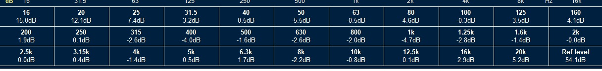

    Litt lek med XTZ room analyzer og RTA måling.
    1: Gamle kurs, 10A høy kildeimpedans = lang kabel til sikring og hovedinntak med Conconanse PW-1 filter
    2: Ny dedikert kurs,16A, 1.3m lav kildeimpedans uten filter.
    3: Som over, men med filteret.
    Siste med filter gir mer støy, ref.level.
    Installasjonen må vel sies å være "støyfri" under måling.
    Muligens at det fremdeles ser noe slik ut målt i stereo kursen uten filter der den første resonansen er varmepumpen. resterende er utenfra.

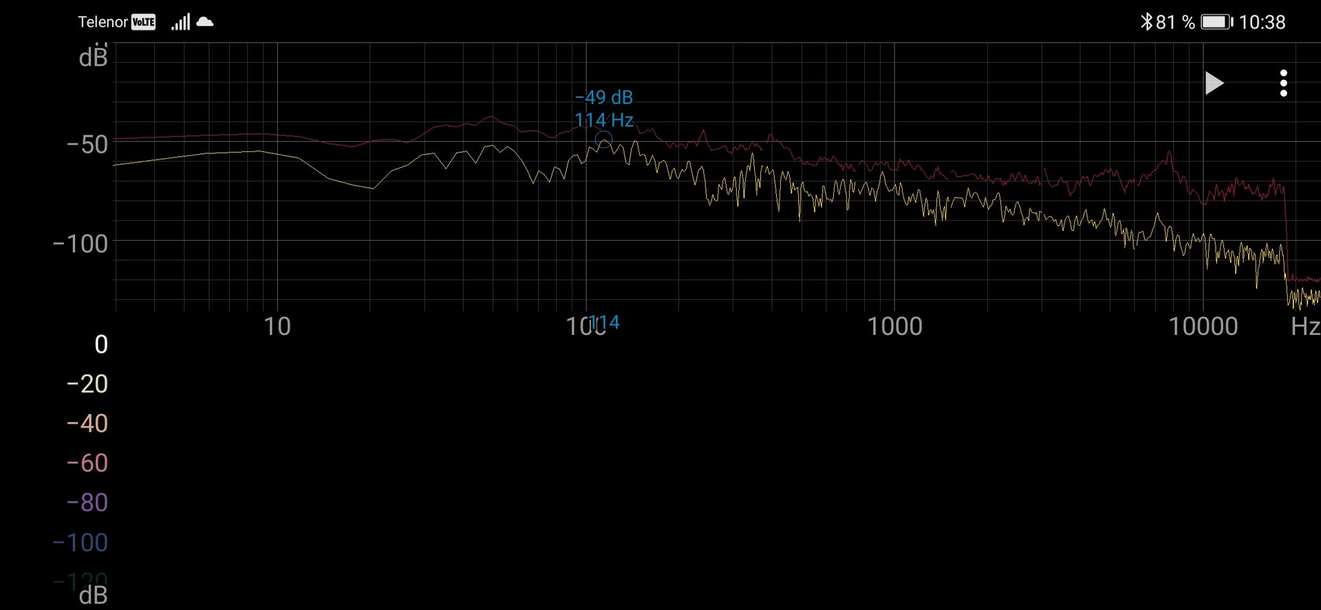

    Stemmer ikke helt hva angår varmepumpen.
    Fant målingen der varmepumpen er avslått,
    oransje kurve. Gir redusert støy. Første resonans blir helt borte.
    Starter rundt - 90bB og så stigende oppover i problem området supraharmonics
    Amir sitt veggstikk.
    - 75bB og sterkt fallende kurve her
    Ikke mye å dempe her

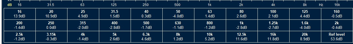

    Sikkert ikke riktig fremgangsmåte. For å komme opp på 53.6dB måtte potmeter opp til ca Kl 3.
    Målingen det sammenlignes med er fra innlegg # 1348, dedikert kurs 16A uten nettfilter og med ringkjernetrafo
    Potmeter den gang vil jeg tro var i området Kl 12 - 13. Potmeter burde vel stått likt, og da ville dagens måling fått ett Ref level mye lavere enn 53.6dB.
    Området 8kHz og opp kan en sikkeret ta med en klype salt,men effekt messig er det ikke mange watt til det området.
    Men tendensen er som på tidligere målinger, ett stort fall.
    Nederste måling er med R - core trafo

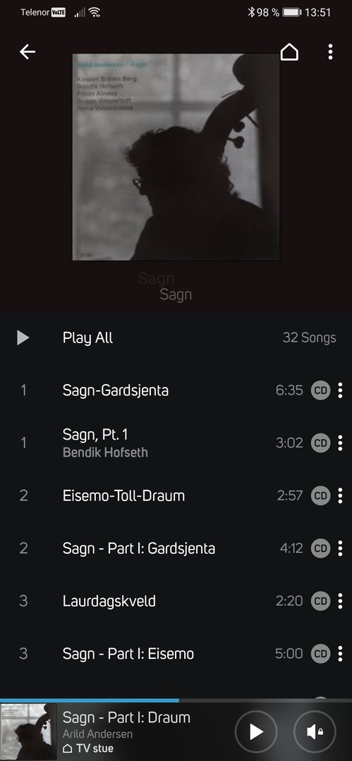

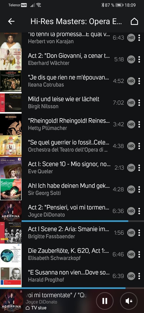

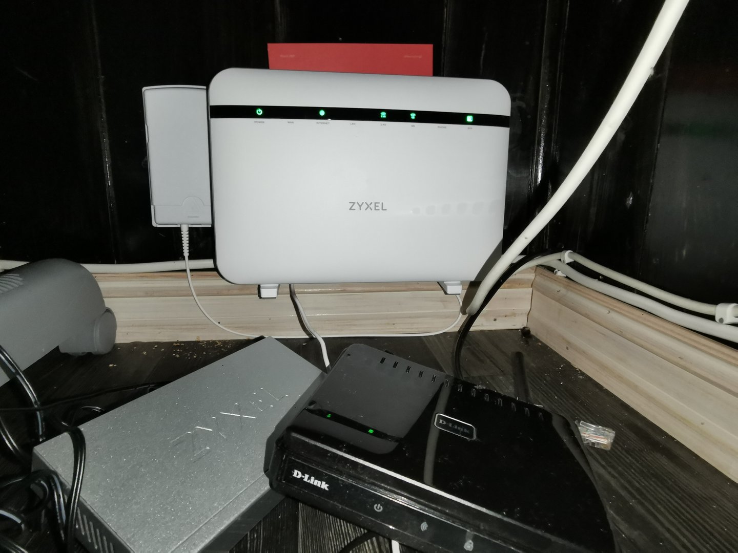

    Så kom kvelden vi ville (kunne) på altibox fibernett da datter var oppom en tur.
    Passord helvete og innlogginger ☹
    Mener at viasat gir bedre bilde.☹
    Dårlig wifi på altibox? Fungerte "bedre" med d link streamet fra Bigblu 10kbs.
    Lastet ned denne
    Ser ut til at jenta ikke fikk til dette.
    Lastet ned som flac fil og ønsket den over til harddisken med rippede cd'er.
    Koblet hardisken tilbake i bluesound.
    Den gikk i hvit lys og "no items found"?
    Du får fyre opp priusen? @breuer 😁
