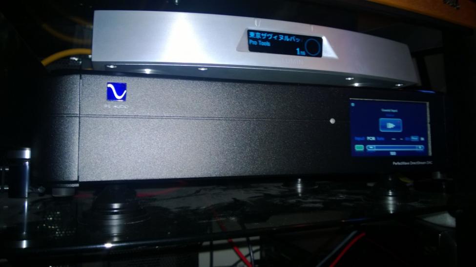

    La nettopp dette inntrykket ut på PS Audio sitt forum for de her inne som måtte være interessert:
    < Ok, here are my initial impressions in my system after 24 hours of burning in;
    The DS doesn't rival the PWD, it completly demolish it! I would never believe the improvements could be this huge.
    The major differences are the following in my setup (Lumin feeding the DS via S/PDIF with native PCM):
    - Immediacy: There is more 'there' there and the sound is distinctively cleaner. Frankly, there is a sense of having more power available.
    - Spatial: There are much more air present around the instruments and everything is handled with a sense of effortless reproduction.
    - Soundstage: Wider and deeper, but not necessarily larger than life.
    - PCM: All redbooks play like it is hirez. This is in fact the biggest improvement of them all and cannot be overlooked.
    - Sensibility: More details are revealed and are easily located in 3D space with no smearing or fuzziness even at very low levels.
    I also like the new gain at 0dB. It suits my preamp better. I am currently using RCA.
    Complaints:
    Sonics: A little early to tell, but mid bass seems a bit hard sounding. Also the mids sometimes appear a little recessed. No glassy treble or sibilance experienced. The unit is continously improving, so no big worries so far.
    Technical performance/Operations: Nothing severe, but here are a few;
    - On my PWD I used the Bridge and had no problems when adjusting the volume on my source. Via S/PDIF I can hear some tics when volume is adjusted on my Lumin player. I am also investigating some DoP issues, however the origin is probably not belonging to the DS.
