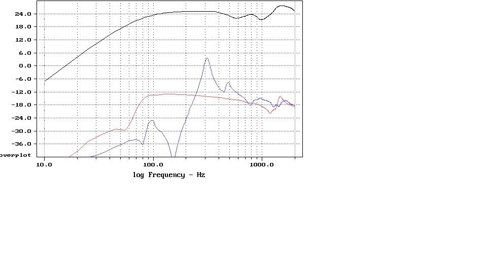

    3.) " ved fast kobling så reduseres bevegelsene i chassis og mer overføres til kabinettet"
    Dette stemmer dårlig med målingene jeg har sett:
    . Blå er fast innspent, rød er avkoblet chassis.
    Jeg deler forsåvidt synet ditt om at bare kassen og chassiset til driveren hadde vært super stivt og tungt så hadde problemet vært løst. Men slik er ikke verdenen som regel. Energi kan bare omdannes til andre former for energi. En slik brute force metode blir fort veldig dyr og tung før den fungerer som tenkt. I praksis er gjerne det beste en kombinasjon av lett, stivt og dempet. Høy masse lagerer energi og er vanskeligere å dempe.

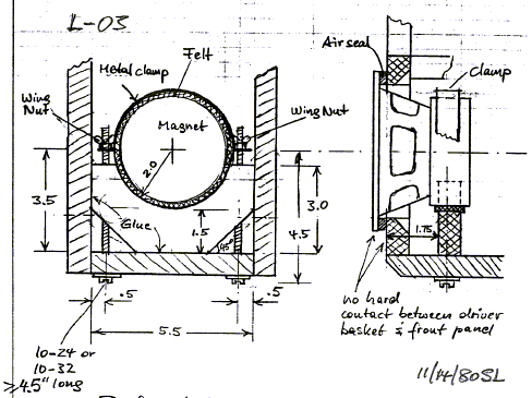

    Det er figur 5 i dokumentet jeg linket til litt lenger opp skrevet av Andrew Jones.
    Her er par andre som bruker samme teknikk:
    speaker Dave, tidligere KEF, Mcintosh,Snell, i dag hos Bose tror jeg:
    The issue came up with the original KEF 105 (not the 105mKII) that was found to have a fairly nasty cabinet resonance in the middle hundreds. Cabinet stiffening moved the resonance up but never got rid of it so rubber mounting the driver was tried. We found that we could get a strong reduction in the amount of "drive" to the cabinet resonances via decoupling. It was easy to measure and you could hear the difference, especially on test impulses or impulsive sound.
    The trick is to get the decoupling resonance low enough. Soft glues, silicon, etc. don't really do it. The 105 II used rubber motor mounts and soft foam tape. We even went to 3 mounting bolts to get the resonance a little lower. You had to be careful that mounting bolts didn't touch the cabinet and "short circuit" the effect. If I remember right the accelerometer measurements showed about a 20dB reduction in resonance levels with decoupling. Even with perfect decoupling their will be an acoustical drive to the cabinet, only the direct vibration coupling is reduced. The later 105 MkII used two woofers in opposition (plus decoupling) for even greater vibration reduction. I think people have even played with dummy motor structures with cone mass substitues that vibrate out of phase and cancel vibration (read about antivibration countershafts in 4 cylinder engines).
    Audiophiles will tell you that dirvers must be rigidly mounted because this is a well ingrained part of accepted dogma. Our tests showed that this wasn't the case.
    David S

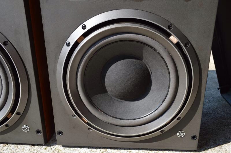

    Dette er et fantastisk langtidsprosjekt, imponerende tålmodighet Asbjørn!
    All den prat om avkobling til kabinettet får meg til å tenke på en Jamo CBR høyttaler fra ca. 1980, der sitter bassen i fire dingser av gummi, og selve refleksrøret er omkring bassen. Retro avkobling.
    Der ligger faktisk et sett ESS AMT 1B på bayen, ganske stilige retro det også.

    Da er nok min erfaring ganske avvikende, jeg ville nok sagt at 80-90% av energioverførselen først kommer når elementet havner i lukket kasse, plasserer man et element i u-baffel og måler/lytter og så lukker du det og gjentar og kassevibrasjoner øker dramatisk
    FredrikC
    16.08.2009
    905
    371
    Det skjer ganske mye med en subwoofer når du tar av lokket. Du endrer jo frekvensresponse,avrulling, utstrålingskarakterestikk osv.
    Snickers-is skrev en gang at veldig mange ville fått et nytt syn på forskjellene mellom kassehøyttalere og di-pol hvis de prøvd en hybrid-dipol. Dvs et element som på baksiden som spiller ute av fase med foran.
    Men klart at når du gjengir veldig lave frekvenser med høyt volum i en liten lukket kasse begynner trykket å bli høyt og da vil veggene flekse noe. Men dett..e vil ikke bli stående å vibrere det vil følge trykket inne i kassen så det vil ikke være noen oppbygning av energi. Samt at ved lave frekvenser kreves det at man beveger store mengder luft for å lage høy lydtrykk. Derfor er dette også mindre kritisk en vibrasjoner litt høyere i frekvens. Og får hver avstiver du har i kassen normalt på flaten du skal hindre i å bevege seg vil den type fleksing reduseres enormt. Du endrer arealmomentet voldsomt for hver avstivning.

    Her er det Linkwitz skrev om dette: Issues in speaker design - 2
    Han foretrekker å montere elementet ved å skru magneten fast til en kloss inni kassen, og så bare ha en myk pakning rundt kanten. Slik:
    Det ville blitt en hel liten utfordring å få til i dette designet.

    Med driveren bakmontert og mannhull i hekken på kassen så burde det vel være greit å få til?
    39.856
    42.189
    Jo, i prinsippet. Men så var det de innvendige matrisene og diverse annet småtteri i dette prosjektet, så det ville blitt en annen høyttaler.

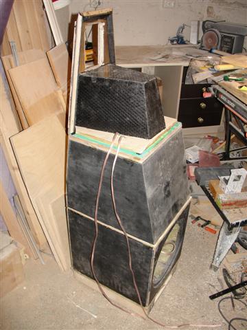

    Liten julestatus på høyttaler #2:
    I tillegg til å vise rotet på hobbyrommet, viser bildet oppbygningen av høyttaleren ganske godt. Høyttaleren består av tre godt avstivede og dempede bokser stablet oppå hverandre med kryssfinérplater mellom boksene. Basskassene er trukket med 2-3 mm myk EPDM-gummi, mens mellomtonekassen er dempet med 4 mm bitumenplater. Den grønne gørra som tyter opp ved siden av internkablingen er Green Glue, viskoelastisk dempemasse som brukes mellom bokser og skilleplater. Ytterkappen limes til disse skilleplatene med mer Green Glue mellom basskasser og ytterplater. Tilskårne plater til ytterkappen står bak høyttaleren.
