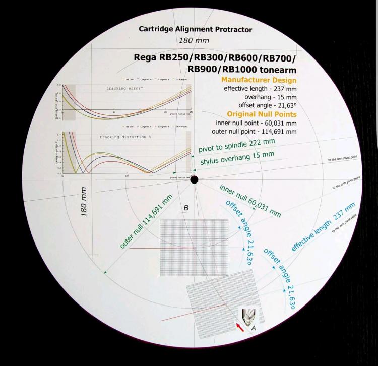

    Dette står på ebay om Legendary Audio sin protraktor for Rega. Så lager de protraktor for andre armer også (Technics, SME, Linn, Micro Seicki, Duel) etc.
    Ut fra det jeg kan se lager de sin egen arc protractor....
    Dette er jeg ikke god på, men resultatet var knall. Hullet på toppen av Lyra har i følge denne protraktor ingenting med det tredje hullet som Rega bruker på sine pu. Nå har jeg bedre dynamikk, klarere stemmer, jeg hører lyder på referanse platene mine som jeg ikke har hørt før og bass og mellomtone ble hakket varmere. Da er jeg fornøyd. Protraktor er av god kvalitet og de lager til flere armer. Rimelige og de er pakket meget godt i stiv papp. Anbefales:) Koster under 200 kroner!!!!
    You're bidding on a custom designed protractor for Rega RB250 / Rega RB300 / Rega RB600 / Rega RB700 / Rega RB900 and Rega RB1000 tonearms!
    Factory made protractors are very basic and are able to align a phono cartridge for quick start of your turntable. This is a professionally custom made protractor which will decrease distortion to a minimum and make your turntable play on a completely higher "broadcast" level!
    This alignment protractor is designed and made especially for this tonearm, so will improve the trackability of your phono cartridge much better then the universal alignment tools!
    Our custom designed protractors are designed for each tonearm in accordance with its specifications and allows cartridge to be correctly installed into tonearm's headshell. Every tonearm is in accordance with its specifications:
    pivot to spindle;
    overhang;
    offset angle.
    Custom designed protractor may be designed in accordance with manufacturer specifications as well as in accordance with Baerwald (Lofgren A), Stevenson, Lofgren B designs.
    Our custom designed protractor is printed on a thick solid paper, supplied with detailed documentation with pictures and packaged into a original carton box!
    It is a private listing, what you see is what you buy!
    Will be very well packed and promptly shipped via insured, trackable delivery.
    Will ship Worldwide at buyers cost and risk - ask for a shipping cost please!
    Best regards, LEGENDARY AUDIO.

    Jeg sier det nok engang:
    Hvorfor ikke bare bruke Conrad' Hoffman's Arc Template Generator i stedet for å kjøpe alskens greier? Da lager man en protractor som er spesialtilpasset nøyaktig den monteringsavstanden ens egen platespiller har, og kan eksperimentere av hjertens lyst med forskjellige geometrimodeller, nullpunkter og radier. Den er gratis, og man kan ikke gjøre det mer nøyaktig. (Gitt at man gjør seg litt flid med å kutte ut senterhullet.)
    Jeg innrømmer at jeg har hatt (har) lyst på en Dr. Feickert-protractor, men det er mest fordi den er en veldig kul dings, og det er lett å bare finne den frem og sette den på. Fin løsning for å treffe senter på armbasen har den også. Tror likevel ikke den blir noe bedre enn "Conrad".

    Jeg har printet Arc protractorer på plastark, disse skillearkene man kan kjøpe til permer. Klipper av bokstaven så det passer i printeren. Fungerer veldig veldig bra

    Neida, selvsagt ikke. Enig i at vanlige 80 grams printerpapir ikke funker til annet enn å kalibrere på testutskrifter. Skriver man ut på fotopapir når man er "ferdig", blir det kjempefint å jobbe med.
    Å skjære ut senterhullet synes jeg fungerer best ved å skjære en likesidet trekant som tangerer hullet på tre sider. Å prøve å skjære ut et rundt hull blir sjeden 100%.
    Der ligger utfordringen med å printe og kutte til en selv. 1-2/10 mm feil her og den kan karakteriseres som ubrukbar.
    Njaæh...
    0,2mm toleranse klarer du neppe i den andre enden uansett, så....
    Det er ikke akkurat presspasning på spindelen (som også har en toleranse) på ferdigtrykte protractorer heller.
    Hmmm, litt usikker på disse billige kjøpevariantene også da om 100µm er nok til å gjøre dem ubrukelige. PVC utvider seg med 80µm/mC, vet ikke hvordan det er med papir?
    Den er god.
    Et par supplerende tips:
    Brug ”billed papir”, tykt papir som er lidt blankt = nål "sætter sig ikke i papiret".
    Sæt et stykke tape på begge sider, inden hullet laves. Hullet kan med fordel laves firkantet. Brug skarp hobbykniv eller skalpel.
    Print på nøjagtig printer, husk 1:1 = ”no scale”. Tjek ved at måle på den efter print.

    Njaæh...
    I kalkulatoren på Vinylengine er det lett å se hva slike avvik har for innvirkning.

    Altså. Jeg lurte på om det er Regas geometri på denne protraktoren, og må innrømme at jeg synes det er en smule hårsårt om det skal gjøre meg til en av 'dere fire'...

    Njaæh...
    Link?
    I praksis er det overhenget som endres 1-2 tiendeler. Det endrer ikke nullpunktene så veldig. Ikke overbevist om at det er hørbart. Målbart? Helt sikkert.
    Det kan jeg godt forstå, for jeg har også lidt svært ved at få øje på det...
    Hvis vi skal stole på https://www.vinylengine.com, så ser alle Regas sådan ud:
    https://www.vinylengine.com/tonearm...ohlo=&ohhi=&search=search&amlo=&amhi=&cw=&mp=
    Hvis vi sammneligner med denne:
    Så er der flere forskelligheder, null points og offset angle :confused:
