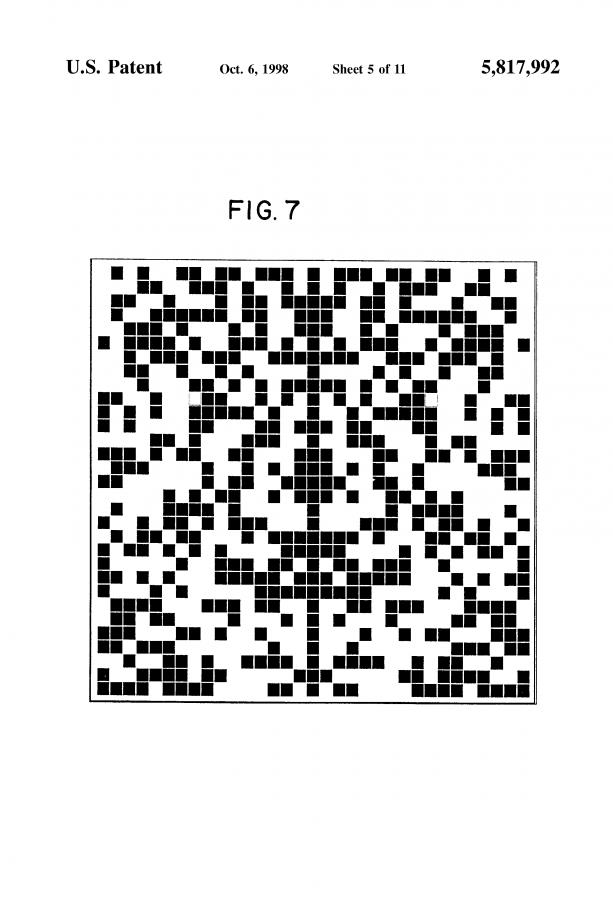

    Til eget bruk er det helt OK og leke med andres patenter:
    Patent US5817992 - Planar binary amplitude diffusor - Google Patents
    Her er noen notater jeg har gjort samt litt klipp og lim fra diverse steder:
    BAD panel diy:3-4 mm MDF (HDF)
    12,5 mm (1/2") hull, 0,66" mønster/grid
    Kjerne: 6-8 pund pr kubikkfot densitet akkustikkplate, semi rigid
    Stoffet må være åpent/pustende
    19mm (3/4") ramme i tillegg til fronten
    Excel ark: https://www.gearslutz.com/board/att...d-panel-detailed-plans-bad-panel-versions.xls
    Mønsteret med færre hull stanser diffusion ved 4500 Hz
    https://www.gearslutz.com/board/bas...-etc/459885-rpg-bad-panel-detailed-plans.html
    I find interesting that the grating is not a rigid thing like a piece of wood or
    metal with holes in it, but either a paper/FRK facing with holes stuck to the
    fiberglass or else the pattern is 'painted' onto the fiberglass through a mask.
    One way to DIY would be to make one panel out of plywood or metal with the
    inverse hole pattern drilled in it and then use it as a mask to spray paint the
    pattern onto the fiberglass.
    I wonder if there is any airspace between the decorative fabric covering and
    the fiberglass/BAD facing.
    Paul P
    Perhaps there are some differences between what's found in the patent and the way rpg is actually building these things.
    I pulled the following text from the word doc at this link: www.rpginc.com/products/badarc/BAD_Arc_Fabric_CSI_Spec.doc
    A. Core: Semi-rigid fiberglass, density not less than 6 pounds per cubic foot and not more than 8 pounds per cubic foot.
    B. Template: 1/8” thick high-density fiberboard, density not less than 95 pounds per cubic foot.
    C. Scrim: White, open weave, fire-rated cloth (required for light-colored fabrics).
    D. Fabric: Open weave, Class A, polyester, without backing such as pattern FR701-2100 by Guilford of Maine (Grand Rapids, MI). Color per architect selection.
    E. Frame: ¾” thick Plywood.
    Based on info I've found, it looks like the standard BAD Panel template is made from 1/8 inch HDF @ 95 lbs pcf. 1/2 inch holes are drilled into the template mathing the pattern in the patent. That is, unless I'm totally misunderstanding what I'm reading!
    I have made several of the BAD-panels for my listening room. Both the curved version and the newest ternary version which also offers a "variable" -1 reflection function, besides the 1 and 0 from the template. I think they work great. Quite straight forward work, plus easy and cheap to DIY, all the holes are a bore to drill though.
    To make Angus grid of 31x33 rows of holes suit a quadratic template, the hole pattern should be 19,19x18,03 mm for a template of 600x600 mm. Making it quadtratic 600x600 mm is only to make it sutable versus existing building and sheet standard dimensions (in the US module 24"x24").
    Some pictures how they turned out: Salong Svarta Katten - Component forum - Page 8 and Salong Svarta Katten - Component forum - Page 11 The larger Ternary BADs along the long walls, each consist of 8 templates with varying positive and negative hole pattern, to decrease possible loobing. Size/pcs is 2,44x1,22 m (96" x 48") with some 4000+ 12 mm holes in each.
    To make the improved ternary version is easy-peasy with a cone made of i.e. 3 mm thick rubber Ø 273 mm. I think you get the picture how, just by looking a bit further up in the thread (in case you got an F in Swedish ;-) )
    Edit: I wrote an excel spread sheet to "tailor make" any sheet size with hole pattern to suit wall dimension in the room. Drop a line, in case you´d like to have it.
