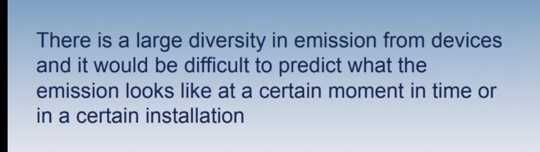

    Slik påvirker støyen strømforsyning
    similar analysis can be done relating the peak voltagedeviations with interharmonic frequency. The interface betweenelectronic equipment and the AC power system is the DC powersupply comprising rectifiers, a capacitor and a regulator. Thepresence of the rectifiers ensures that only the AC voltage peakscharge the capacitor voltage. Since, from one cycle to another,these peaks always reach the same amplitude, the regulatorcorrects the fluctuations at the capacitor terminals.The addition of harmonics to the supply signal does not affectthe fluctuation because these harmonics are synchronized withthe fundamental of the power system. However, interharmonics,which are not synchronized, do affect the peak amplitude of theAC voltage supply (Figure 7). Consequently, recharging of thecapacitor varies from one cycle to another, resulting in anincrease in the fluctuation upstream of the regulator and, sincethis fluctuation is excessive, it affects the operation of the equipment.
    Er litt rart at de som forsøker å ordne opp i problemet måler problemet på DC siden mens folk som denne Amir ikke klarer det.
    Kan jo være at han i praksis ikke har noe støy eller at han ikke vet hvordan de måler problemet på DC siden.
    . Sources of Supraharmonics
    There are different sources of supraharmonic emissions. In general, all devices with converter-based power electronics emit supraharmonics to a certain extent, as an artifact of the conversion from AC to DC or vice versa. In this research, only the effects on the power quality at the AC side are presented. Nevertheless, effects on the DC side can be present but fall outside the scope of this research.
    En forskrift er vel ikke påkrevd dersom det ikke skaper problemer på DC siden og at problemet ikke lar seg verifisere med målinger?
    "Nevertheless, effects on the DC side can be present but fall outside the scope of this research."
    Med slik ordlegging er der ikke mye rom for å diskutere.
    Det som diskuteres og forskes på er hvilke situasjoner og hvilke forhold som må være til stede for at det oppstår problem.
    Og da er det som Rønneberg sier
    Så da vil det være direkte feil å bruke kun egne erfaringer som bevis for at elektronikken ikke påvirkes.
    En trenger kanskje ikke gå lenger enn til naboen før støyverden ser helt annerledes ut.Eller på en annen kurs i egen installasjon
    Når en ser hvilke målinger og hvilken instrument park som trengs for å komme helt i mål så er det ingen her som besitter slikt utstyr, ei heller hvordan det skal måles.
    SB, min mann hos netteier leser seg opp på supraharmonics, men sier også att rent måleteknisk blir det en utfordring.

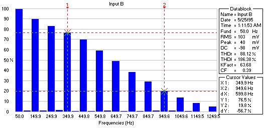

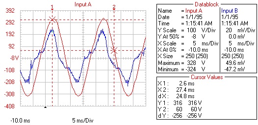

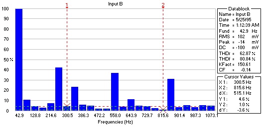

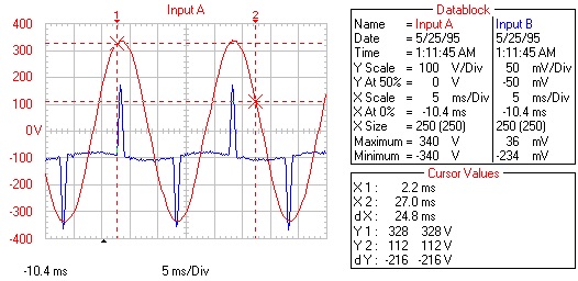

    Laster opp noen få målinger til orientering.
    (1) UPS MED LIKERETTERLAST, STRØM + SPENNINGSKURVE
    (2) LIKERETTERLAST ANNEN UPS STRØM + SPENNING (BLANDET LAST)
    (3) HUSKER IKKE DETALJER MEN SPEKTRUM STRØM
    (4) SANNSYNLIGVIS SPEKTRUM STRØM I (1)
    (5) SANNSYNLIGVIS SINUSFORMET STRØM
    (6) ENFASE LIKERETTERLAST I NORSK TREFASET IT NETT. 2 STRØMPEAKER PER FASE

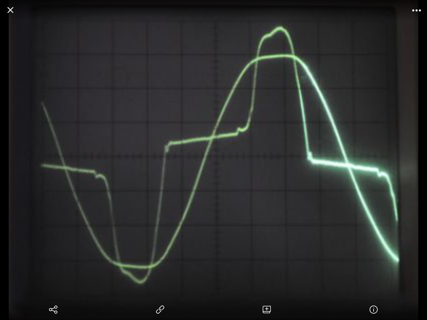

    Prospect
    27.08.2013
    135
    74
    Ute i det friere landskap (heldigvis)
    Vis vedlegget 739024
    Øverste, forsynt fra sentralnettet og under fra diesel aggregat.
    Dårlig elektronikk er unnskyldning for de som ikke skjønner sammenhengen.
    Men nederste måling utgjør for mange en positiv tilskudd sen kveld natt
    [/QUOTE]
    Om en forutsetter at både 50hz og overharmonier av denne alle er sinuskurver, eller variasjoner av sinus kurver som faktisk leverer energi.
    Er det da rimelig å anta at harmoniske og uharmoniske forvrengninger genererer strømmen som utgjør de ekstra 0;8db i totalt lydtrykk?
    Kan så resultatet av HF harmonier som da nødvendigvis måtte sende HF DC pulser inn i strømforsyningen føre til et høyere fokus på tilsvarende frekvenser ut til HT?
    I Ymirs målinger over så ser jo i tilfelle den ekstra energien fra sentralnettet ut til å ha blitt tilført over og under 400hz og 1khz, og i lett hørbare mengder

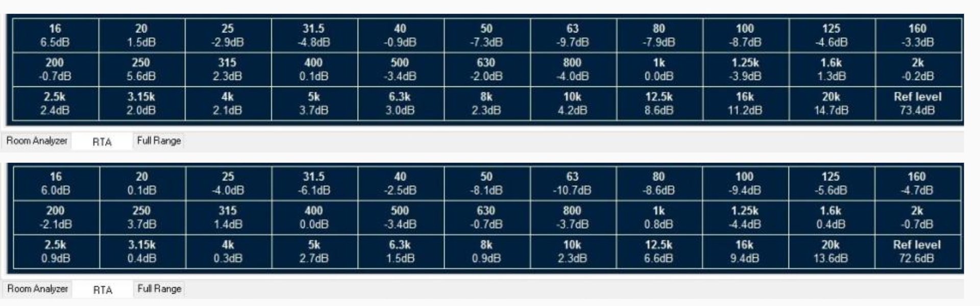

    Litt på tygge på de målingene der WayAhead.
    Om jeg oppfatter rett så viser din måling, "(5) SANNSYNLIGVIS SINUSFORMET STRØM ", en gradvis nedtrapping av overharmonisk strøm til over 1,2Khz som vil utgjøre en vesentlig andel av total effekt levert inn til forsterker, mens Fig 4 viser et veldig bratt fall i forhold.
    Figurene kunne nesten vært direkte oversatt til forskjellene i opplevd frekvensgang ut/ lydbilde ut ved gode og dårlige forhold der lydfrekvens ut korrelerer sterkt med strømfrekvens inn.
    Det eneste som mangler er den ekstra energien som også pleier å komme inn lenger opp i frekvens, men nå går jo ikke dine målinger så langt opp heller.
    na_X
    04.09.2013
    5.055
    4.556
    På N-te harmoniske så forsvinner mer og mer støyen fra 50 Hz (eller hvilken som helst annen lav frekvens), når man starter å komme over 2 KHz så er det mer av akademisk karakter og målinger for morro skyld om man har bra nok utstyr til disse målingene. Har man en normalt god likeretter med en kraftig kondis i parallell med likeretter så glatter dette ut det meste av spenning. Man kan like gjerne sette et batteri der istedet.
    Det er uansett såpass mange dB under lyden som kommer fra kilden her på "støy fra nettet", at her kan man gjerne bare se bort ifra støy (om man da ikke har ekstreme strømproblemer som det tydeligvis blir bare flere og flere innpå forumet her som får, virkelig en morsom mote eller så kan det like gjerne være overpriset dårlig utstyr).
