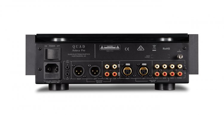

    Artera Pre
    Analogue Preamplifier
    The QUAD Artera Pre is a pure analogue preamplifier, combining innovative modern British design with the QUAD sound signature traditions, characterized by the pure analogue signal. The Artera Pre mixes minimalist design with high-quality components to ensure short, direct signal paths that preserve sonic purity.
    SOEDAL
    22.03.2002
    3.105
    524
    Tror jeg må ha en slik en etterhvert.
