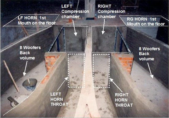

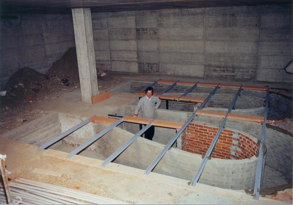

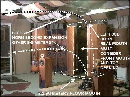

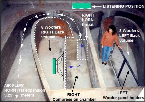

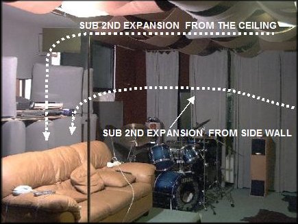

    It is important to get the maximum from the room. In our room, when you play Jurassic park cinema track, when there is the dynosaurous coming, you orribly feel all the walls crashing down (many people got scared, now I normally ask if they are ready to be scared) is something that you cannot even get in a cinema show, this is because all the frequencies (low bass also) are focused all to the listening point, while in any cinema show you normally are not able to do it. The full 10 Hz frequency response depends on this. 5 Hz we cannot measure, but you can feel them easyly on your body. 30 Hz is lower in amplitude because of the phase of the emission made by the frontal speakers bass horn. Nothing in this Audio room has been done by a case and this is one of the topics that has been well thought before building it.
    If you have a look to the room again you will notice that it looks like that horns are continuing after the sub horn mouths for 10-20 Hz frequency range.
    The room itself as it has been shaped is a horn below 20 Hz, then actually the holes in the floor are not really the final mouths below this frequency and the length from the throat to the listening position is half of a wavelength of 10 Hz. That is why we are getting response down to 10Hz better than 30 Hz.
    THE BIGGEST HORN SUB OF THE WORLD by Roberto Delle Curti ITALY
    Vis vedlegget 235637
    Vis vedlegget 235631
    Vis vedlegget 235632
    Vis vedlegget 235633
    Vis vedlegget 235634
    Vis vedlegget 235635
    Vis vedlegget 235636

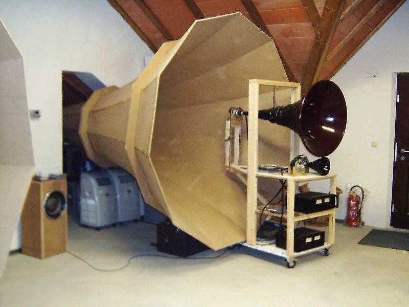

    Aha... Det var dette LMC var inne på tidligere i denne tråden.
