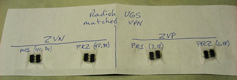

    Har lett febrilsk etter to poser med matchede IRFP240 / IRFP9240, finner de bare ikke ! Hele 18 par ! Utrolig! :mad:
    Jeg selger jo disse transene, men så mange like par klarer jeg bare ikke å matche lengre av de som er igjen.
    Så hva gjør man ? Heldigvis har jeg gode kontakter i Diy-verdenen, så jeg fikk haffet til meg disse fra en Diy-venn fra Bulgaria.
    Har handlet med han før, og har bare gode erfaringer med det han leverer. Disse kom i posten i dag, bra matching ! Så da er prosjektet med Pass XA160 klonene reddet :)
    Ellers venter jeg på nye pre-fabrikerte UGS-moduler fra Canada til Pre-ampen. Har stor tro på disse. Pre-ampen blir målt på nytt hos Armand når disse er i hende :).

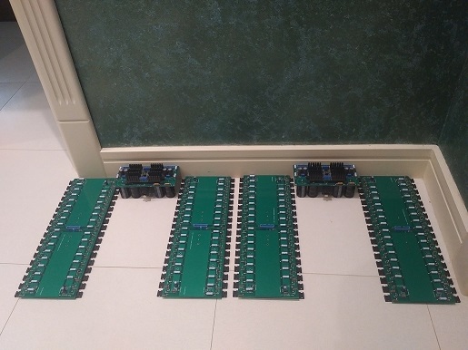

    I personally recommend you to measure them once more, to be sure they are perfect matshecd.
    We had unpleasant surprises from sets bought from trusted people on diyaudio.
    Here's what the Vgs looks like at 36 pairs of IRFP9240 (left curve).
    On all 36 IRFP240 was written Vgs 3.14. Actually it was not.
    Neither the IRFP240 is perfect, all 36 was written Vgs 3.24.
    Same situation with 2sj313 / 2sk2013 :(
    But maybe it's wrong, and you're lucky to be as it says on them and be perfect.)
    I was inspired to buy this Curve Tracer locky_z's Intelligent curve tracer PCB.
    With it I was able to select 72 IRFP240/9240 pairs , for my project version 8.
    Best regards,
    Vitali

    I have been looking at your pictures of your pcb's . Driver pcb: Something that I dont find, is a flatcable connector for the meter in the frontpanel ? And what about the the standby relay, can't see that ? Do the driver pcb's have bias measurement points ?
    Maybe I'm wrong, and your pictures do not show all the features ? Any smd components on these pcb's ?
    Output pcb's: Looks great. Are they double sided ?
    Kind Regards
    Johnny
    vitali
    13.12.2014
    20
    21
    Hi Vitali :)
    Kind Regards
    Johnny
    Hi Johnny,
    "Something that I dont find, is a flatcable connector for the meter in the frontpanel ? And what about the the standby relay, can't see that ?" - I gave up on them, I do not use them.
    "Do the driver pcb's have bias measurement points ?" - are on Output pcb .
    "Output pcb's: Looks great. Are they double sided ?" - Yes, double layer.
    "Any smd components on these pcb's ?" -- no SMD, only 1% matshed resistors.
    Today I'm done with the plates:)
    Best regards,
    Vitali

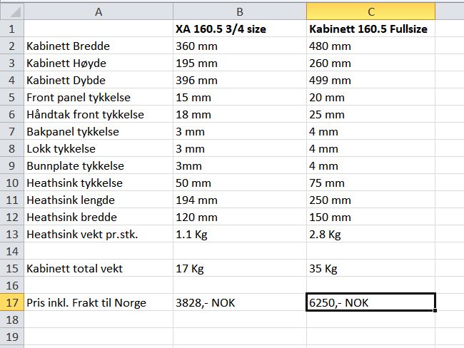

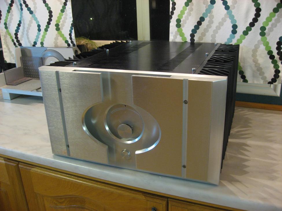

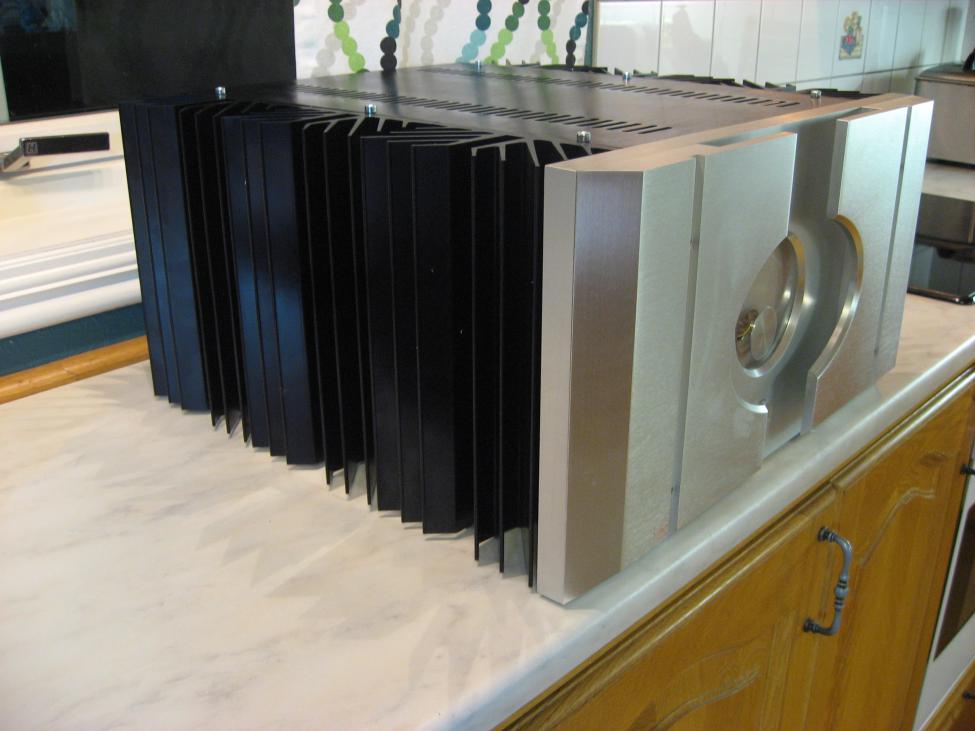

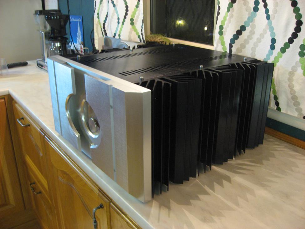

    Nei, det er IKKE samme kabinett. Du har jo kjøpt denne:https://www.aliexpress.com/item/Big-Aluminum-Chassis-PASS-Class-A-Power-Amplifier-Enclosure-DIY-Case-Hi-End-Box/32659859491.html?spm=a2g0s.9042311.0.0.uXemWG
    Som teksten sier : "This aluminum chassis is Three-quarters the size of the PASS XA160.5". Altså bare 75% av full størrelse som mine "fullsize kabinetter". Dette gjenspeiles også i prisen .
    3/4 size kabinett (som du har kjøpt) https://www.aliexpress.com/item/Big...32659859491.html?spm=a2g0s.9042311.0.0.uXemWG . Koster: US $481.96 inkl. frakt til Norge.
    Mine Fullsize kabinetter ser du her: https://www.aliexpress.com/store/pr...195.html?spm=2114.12010612.0.0.31a080c1c4KVi3 . Koster US $786.74 inkl. frakt til Norge .
    Altså : STOR forskjell i størrelse og for ikke snakke om pris ! Prisdifferansen er på hele US $ 305,- pr. kabinett ! (1949,- Danske kroner pr.kabinett !)
    Altså, det gjelder å lese annonseteksten: "This aluminum chassis is Three-quarters the size of the PASS XA160.5".

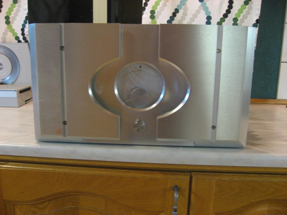

    Kan du fortælle mig hvordan Vu meter skal tilsluttes?
    Dette er ikke et VU meter, men et ampere meter. Jeg tilslutter det til mine driverkort, og det skal vise bias, slik som på en original Pass Labs.

    Hei,
    satte raskt opp en sammenligning mellom de to kabinettene. Det er STORE forskjeller !
    Se her:
    Drossel
    05.05.2012
    10.866
    3.692
    Hmm hvis jeg havde vist det havde jeg kanskje købt de store så det er godt jeg ikke vidste det. Til formålet er disse fine. Jeg klarer å få plads tror jeg. Til klasse AB.
    Jeg laver det så det bliver muligt å brokoble til 900 W i 8 ohm.
